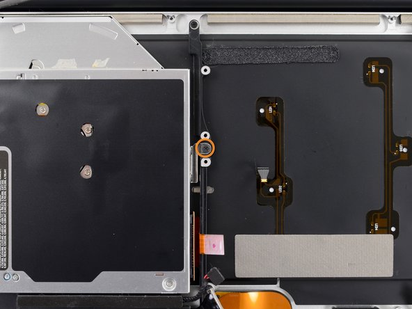

  28. MacBook Pro 15" Unibody Late 2008 and Early 2009 Trackpad Replacement, Trackpad: crwdns2935265:028crwdnd2935265:01crwdnd2935265:01crwdne2935265:0
    • Deroute the camera data cable from its channel on the optical drive.

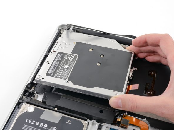

  29. MacBook Pro 15" Unibody Late 2008 and Early 2009 Trackpad Replacement: crwdns2935265:029crwdnd2935265:01crwdnd2935265:03crwdne2935265:0 MacBook Pro 15" Unibody Late 2008 and Early 2009 Trackpad Replacement: crwdns2935265:029crwdnd2935265:02crwdnd2935265:03crwdne2935265:0 MacBook Pro 15" Unibody Late 2008 and Early 2009 Trackpad Replacement: crwdns2935265:029crwdnd2935265:03crwdnd2935265:03crwdne2935265:0
    • Remove the following three Phillips screws securing the optical drive to the upper case:
    • Two 2.5 mm Phillips screws.
    • One 3.5 mm Phillips screw.
    • Lift the optical drive out of the upper case.

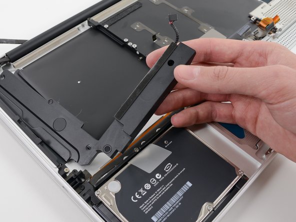

  30. MacBook Pro 15" Unibody Late 2008 and Early 2009 Trackpad Replacement: crwdns2935265:030crwdnd2935265:01crwdnd2935265:02crwdne2935265:0 MacBook Pro 15" Unibody Late 2008 and Early 2009 Trackpad Replacement: crwdns2935265:030crwdnd2935265:02crwdnd2935265:02crwdne2935265:0
    • Remove the following four screws securing the subwoofer and right speaker to the upper case:
    • Two 3.2 mm Phillips screws.
    • One 2.6 mm Phillips screw.
    • One 5.0 mm Phillips screw.
    • Lift the subwoofer and right speaker assembly out of the upper case.

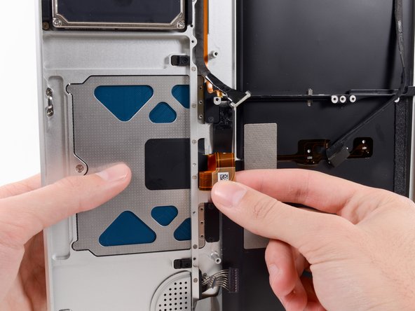

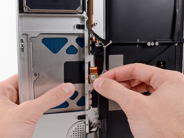

  31. MacBook Pro 15" Unibody Late 2008 and Early 2009 Trackpad Replacement: crwdns2935265:031crwdnd2935265:01crwdnd2935265:02crwdne2935265:0 MacBook Pro 15" Unibody Late 2008 and Early 2009 Trackpad Replacement: crwdns2935265:031crwdnd2935265:02crwdnd2935265:02crwdne2935265:0
    • Insert the flat end of a spudger underneath the trackpad ribbon cable and gently peel it up from the adhesive securing it to the upper case.
  32. MacBook Pro 15" Unibody Late 2008 and Early 2009 Trackpad Replacement: crwdns2935265:032crwdnd2935265:01crwdnd2935265:01crwdne2935265:0

  33. MacBook Pro 15" Unibody Late 2008 and Early 2009 Trackpad Replacement: crwdns2935265:033crwdnd2935265:01crwdnd2935265:01crwdne2935265:0
    • While holding the edge of the trackpad closest to the logic board with one hand, remove the six 1.3 mm Phillips screws securing the two brackets to the trackpad.
  34. MacBook Pro 15" Unibody Late 2008 and Early 2009 Trackpad Replacement: crwdns2935265:034crwdnd2935265:01crwdnd2935265:03crwdne2935265:0 MacBook Pro 15" Unibody Late 2008 and Early 2009 Trackpad Replacement: crwdns2935265:034crwdnd2935265:02crwdnd2935265:03crwdne2935265:0 MacBook Pro 15" Unibody Late 2008 and Early 2009 Trackpad Replacement: crwdns2935265:034crwdnd2935265:03crwdnd2935265:03crwdne2935265:0
    • While holding the trackpad in place with your left hand, fold the top of the trackpad ribbon cable down with your right hand so that it fits through its slot in the upper case.
    • Feed the ribbon cable through the slot as you push the portion of the trackpad closest to the keyboard out of the upper case.

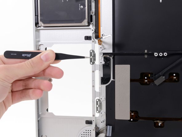

  36. MacBook Pro 15" Unibody Late 2008 and Early 2009 Trackpad Replacement: crwdns2935265:036crwdnd2935265:01crwdnd2935265:02crwdne2935265:0 MacBook Pro 15" Unibody Late 2008 and Early 2009 Trackpad Replacement: crwdns2935265:036crwdnd2935265:02crwdnd2935265:02crwdne2935265:0
    • To replace the trackpad brackets, you must first remove the black covers that hold them to the upper case.
    • Remove the four 2.7 mm Phillips screws from the two trackpad bracket covers.
    • The small metal brackets may fall off once the covers are removed. When replacing them it is easiest to set them in place with a pair of tweezers.
