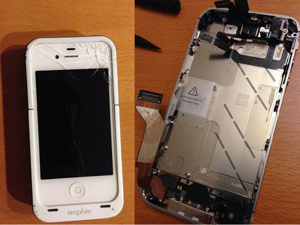

Wife's iPhone4S decides to pick a fight with concrete sidewalk and had battle scars to prove it. I'd figure it's out of warranty and I will give it a shot at replacing the screen myself and save a few bucks.

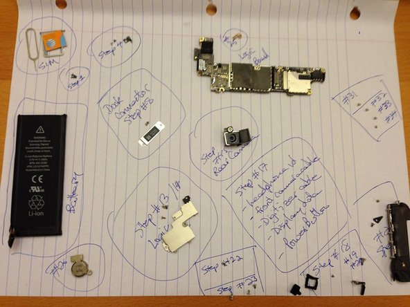

Overall, it took 1.5 hours for the whole process. It was a bit frustrating trying to keep track of the screws/parts.

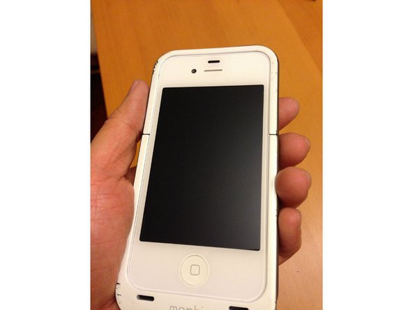

Once the new screen was in place and re-assembly started, I felt more comfortable.
Step-by-step guide provided by iFixIT is extremely thorough. Even when I had doubts or questions as to what certain parts were, the illustrations helped me refresh my memory.
Order iFixIT's Magnetic Project Mat.
Take your time and read the instructions first before starting so you would have an idea of the steps.
