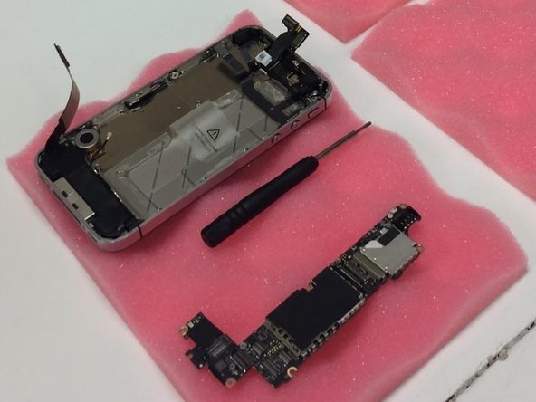

The display screen was broken when the phone was dropped and the metal band around the edge of the phone contacted a rock and bent into the screen. This created the opportunity for me to revert back to a 4th grade habit of taking everything apart.
Thanks to the great step by step directions on ifixit, the parts and tools also available on ifixit, the display replacement went perfectly.
I was amazed that it worked based on a complete lack of prior experience with tiny electronics.
The best advice I would offer to inexperienced folks like me, do not be intimidated by the opportunity and pay very close attention to the instructions.

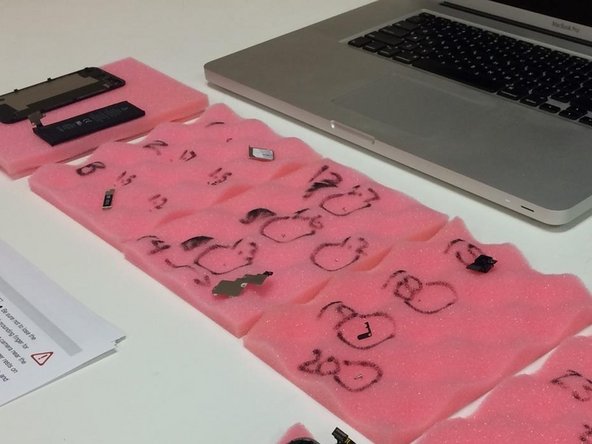

Take your time, I moved very slowly, taking almost two hours to complete the process Ifixit gives the task a 1 hour estimate for comparison.
Small but significant detail, I used a non-static foam to place all the parts on, labeling each step and the specific part / size of screw etc to make the reassembly easier.
