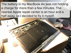

Tired of keeping a charger in every room because your laptop battery can’t hang? Fed up with your “portable” computer that can’t leave your desk for more than 30 minutes? Or maybe you’re just sick of fighting for the outlet-equipped seat at your favorite coffee shop, missing out on that choice seating only useful to patrons with plenty of battery life. It doesn’t matter who you are or how well you treat your laptop’s battery—it will eventually die. It’s normal. What’s not normal is that most people don’t know how or when to replace it themselves.
The good news is that if you have a MacBook—anything not in the Retina line—we pinky-promise that replacing the battery yourself is easier and faster than you think. (Don’t worry, Retina owners, we’ve got a battery solution for you, too—it just takes a little more TLC to do the repair.)
