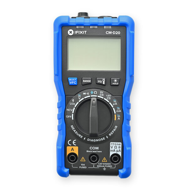

Boards and wires and solder are the precursors to learning about the working bits of the board they connect. On day two, we learn about capacitors, resistors, transistors, filters, chokes, diodes, buck and boost converters, mosfets, and coils. Using a multimeter, mostly in diode mode, with the red probe on ground, you poke at components and look for three key failure readings:
- Open (or “broken open,” as Jessa prefers), when a component fails and leaves the circuit incomplete. The multimeter reads “OL” (“open loop” or “overload”). The circuit has no continuity, and has nearly infinite resistance to the ground.
- Short, an unintended connection, usually to ground. The multimeter reads “0.0,” because there is no resistance between the probe on ground and what you’re poking—it’s already going to ground.
- A resistance reading hugely different from the typical resistance readings on your schematic or crowdsourced diagrams (more on those in just a bit).
It’s a lot to absorb, but there is good news: that’s basically all the required reading for Microsoldering 101. The reason your phone dies when you drop it, bend it, dunk it in water, or charge it with unstable power is because one of those board components is short, open, disconnected, or damaged in some weird way.
