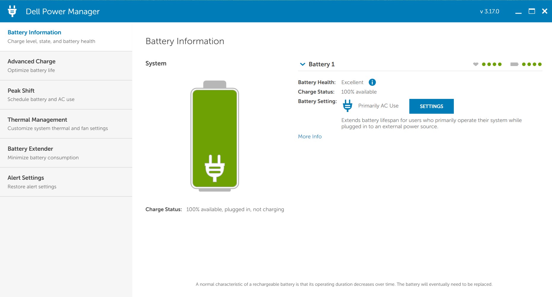

Some OEMs may offer insights into the state of your laptop battery using specific software like Lenovo Vantage, Dell Power Manager and HP Support Assistant. While the software provides a more user-friendly way to access the battery health information, the data presented tends to be less comprehensive and thus less accurate than the information provided using the Windows command.
