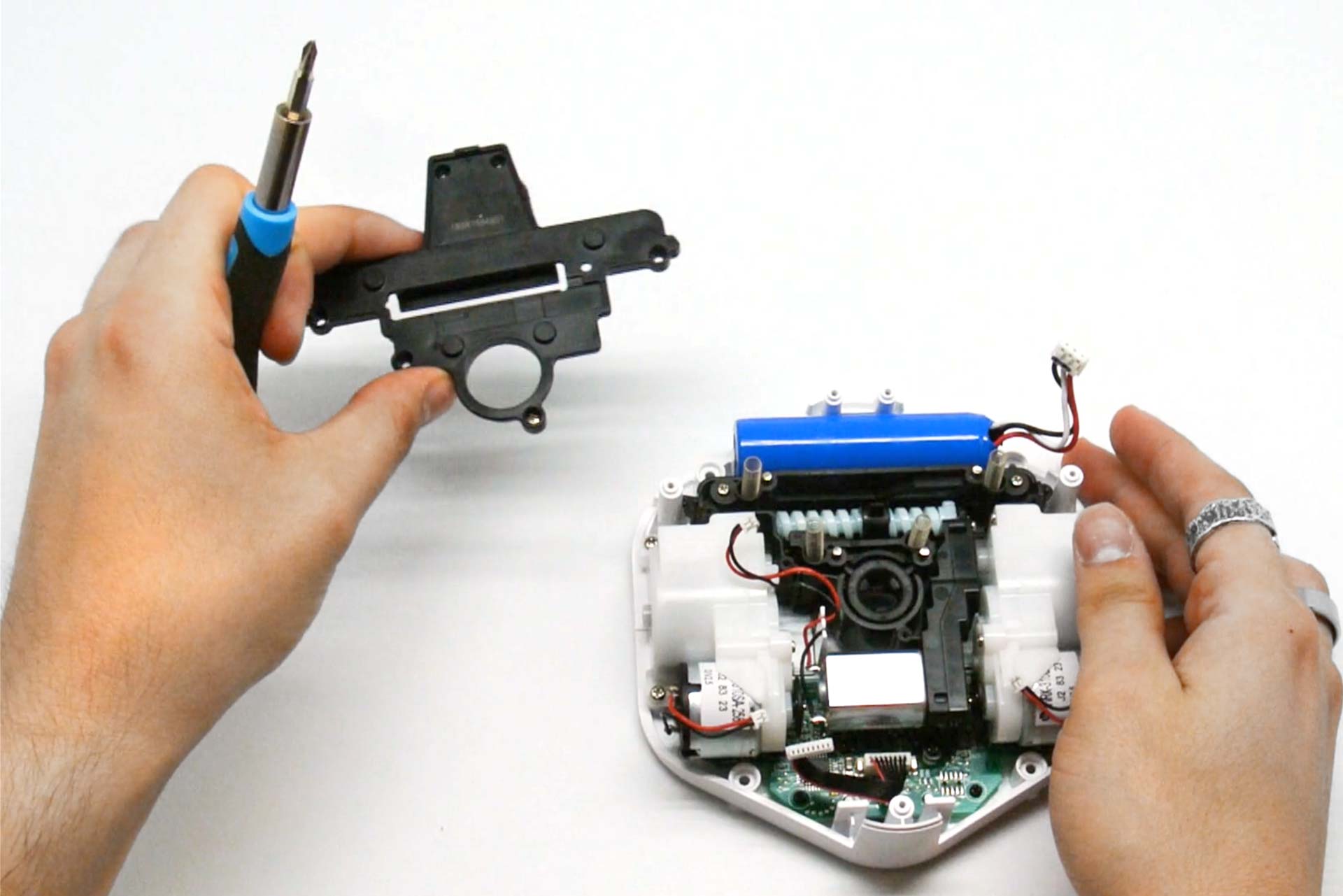

A TTS Blue-Bot coding robot is disassembled at the hands of an EPFL robotics student.
Cute AND sophisticated: These charming bots have some real hardware under the hood. (From EPFL’s Blue-Bot disassembly guide)

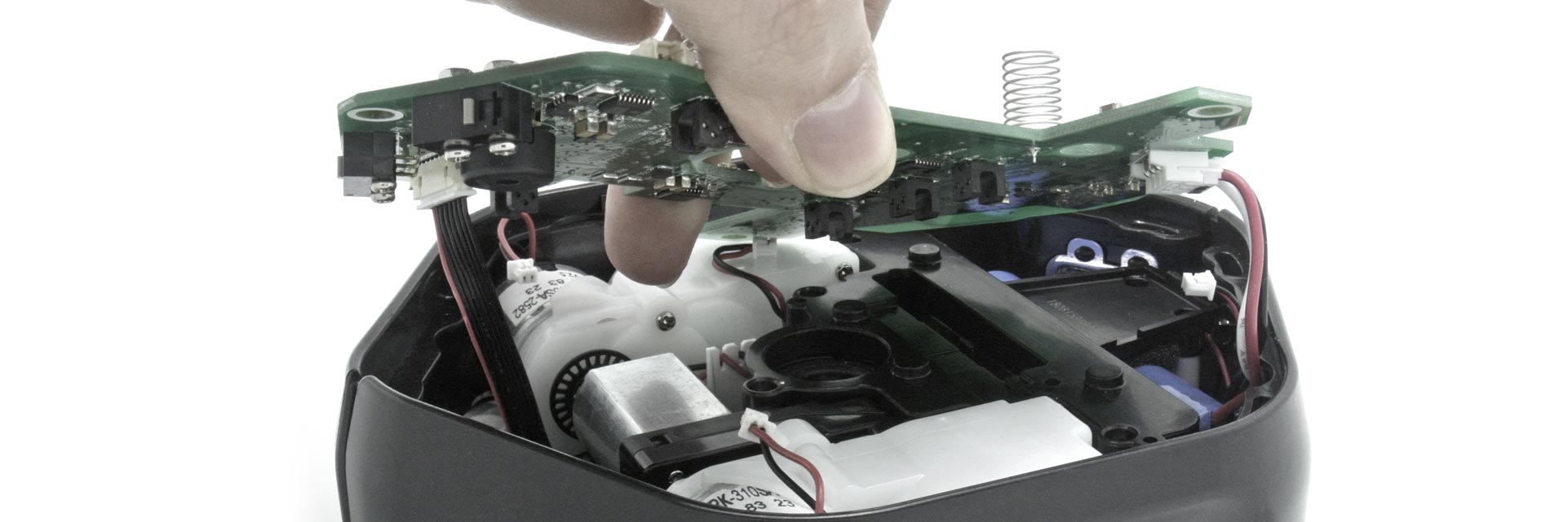

A robotics student uses a screwdriver to remove parts from a partially disassembled iRobot Root coding robot.
The iRobot Root gets the teardown treatment at the hands of EPFL’s student robotics team.

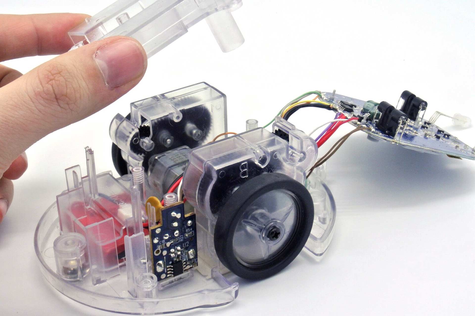

The EPFL team was up to the challenge. They tore down every robot, documented the process with videos, and scored them on design choices, parts availability, tools required, and availability of repair documentation. The results spread out nicely—exactly what you want in a meaningful, robust scoring system.
