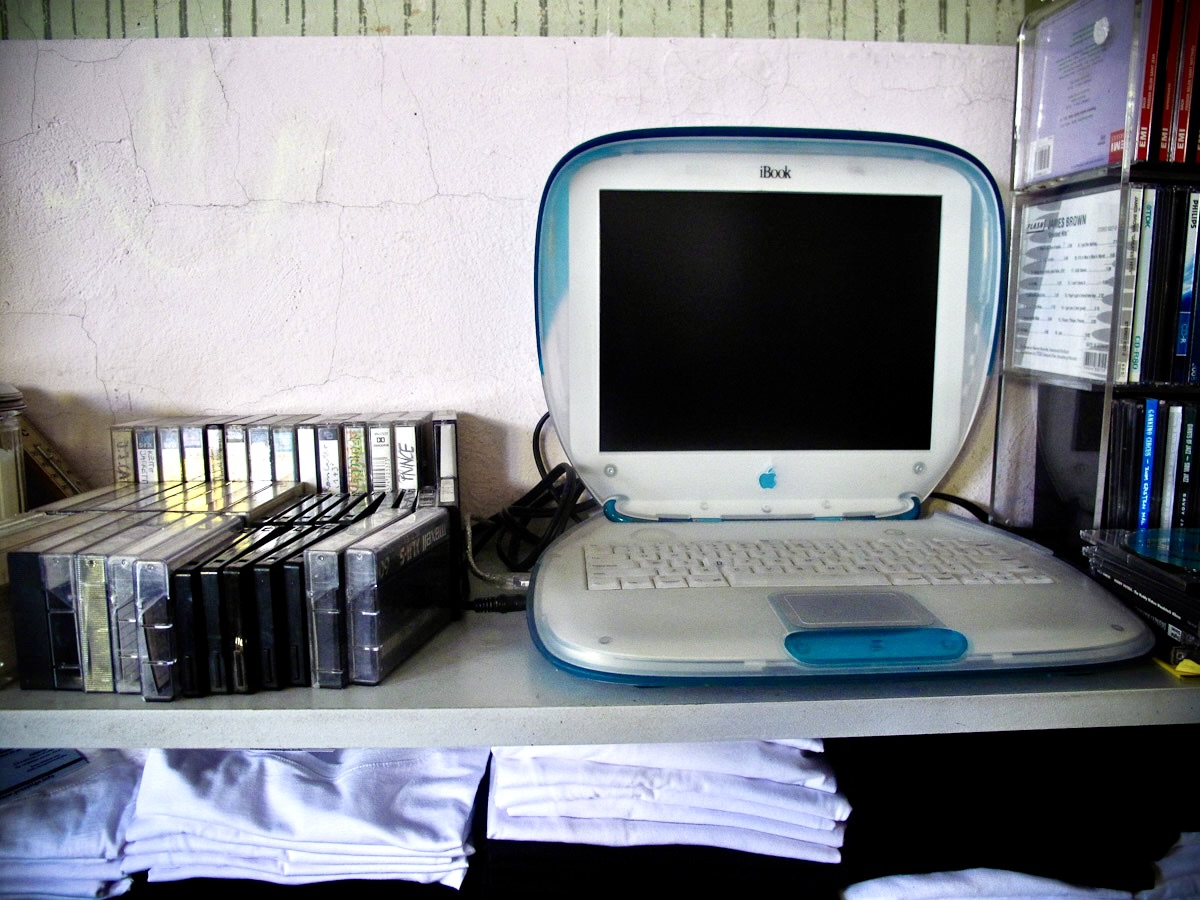

My iBook, bought in 2001, ran fine until around 2006/2007, when the screen would glitch out and then die. A reboot would sometimes fix it, sometimes not. In the end, after a lot of internet research, I found that this model often had a problem with its graphics chip. Its plastic body flexed quite a bit, and the stress on the soldered joint would eventually cause the graphics chip to detach from the main board.
My first fix involved opening up the machine and shimming the chip with a piece of a card beermat, and that worked for a few months. Eventually, though, after sticking ever-thicker shims over the chip, and dealing with an ever-bigger bump in the bottom case, I decided it was time to reflow the solder.
iFixit existed at this time, recently renamed from PB Fixit. I’m not sure if it sold any tools that I could use to reflow solder like it does now, but in the end I borrowed a heat gun, the kind you use for stripping paint. The idea was that if I could heat the offending chip enough, its solder would melt and reflow back into the dry joints. The problem was, that heat wasn’t particularly controllable, and as this was my first time doing such a thing, I was kind of terrified I would end up killing the computer.
In the end I had to make four or five attempts, each a little bolder than the last, with the rest of the computer and circuit boards shielded with tinfoil, and wooden chopping boards. In a perhaps unscientific fit of inspiration, I snipped off a length of solder and timed how long it took to melt under my heat gun, and used that as a rough guide. In the end, it worked, and the computer never had a graphics glitch ever again.

But that was not the end of major repairs on this now-beloved machine. A few years later, it stopped charging reliably, and as the battery was also on its last legs, that was a problem. I narrowed it down to a broken power socket. This was pre-MagSafe, and Apple’s laptops then used a cylindrical power plug and socket.
Spares were available, but I was a poor gadget blogger and I wasn’t going to waste money on that when I could surely come up with a DIY fix. After all, I’d already beat this computer once.
iFixit Smart Soldering Iron
Great for fixing up iBooks—and anything else.
The fix was ugly, but it worked. I desoldered and removed the old power plug from inside the iBook, then I snipped a phone cable—the kind you use to connect record and CD players to hi-fi amplifiers—in half. I soldered the wires of one half of the cable to the power terminals in the iBook and used the other half to replace the plug on the charger. I wired it so that the live wire ran to the central pin of the female plug, because I’m not a monster.
This hack lost the colored orange/green status light on the original plug, but otherwise worked just fine. If having a computer with a 10cm cable permanently hanging out of a hole in its side can be considered “fine.”
