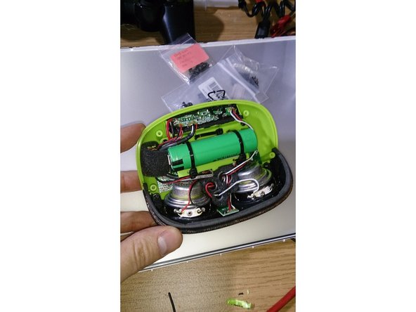

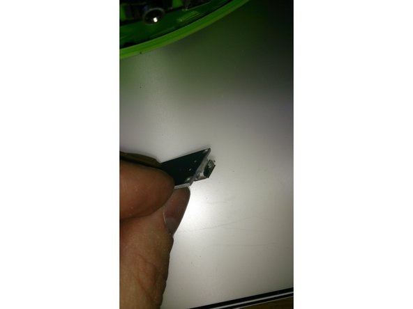

  2. xqisit xqBeat Battery Replacement, clip off unneeded "speaker"-support (optional to make room): crwdns2935265:02crwdnd2935265:01crwdnd2935265:02crwdne2935265:0 xqisit xqBeat Battery Replacement, clip off unneeded "speaker"-support (optional to make room): crwdns2935265:02crwdnd2935265:02crwdnd2935265:02crwdne2935265:0
    • to make room for the 18650 cell i clipped off the useless construction on the "bass-speaker"
    • you can leave it there if you only intend to replace the battery with a similar one
    • post note: this "speaker" may have some sound benefits. also i had to replace the black membrane with a stiff plastic cover beacause the vibrations were hitting on the 18650-cell.

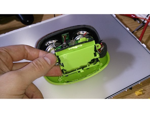

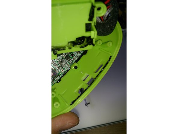

  3. xqisit xqBeat Battery Replacement, remove the dead battery: crwdns2935265:03crwdnd2935265:01crwdnd2935265:03crwdne2935265:0 xqisit xqBeat Battery Replacement, remove the dead battery: crwdns2935265:03crwdnd2935265:02crwdnd2935265:03crwdne2935265:0 xqisit xqBeat Battery Replacement, remove the dead battery: crwdns2935265:03crwdnd2935265:03crwdnd2935265:03crwdne2935265:0
    • unsrew the two scres on the side and twist the thing to get to the battery
    • its glued in place so with a little force you can remove it.
    • cut off the wires maybe in the middle or so...
    • if you want to or have one lying around you can solder a new similar battery to the terminals and you're done.

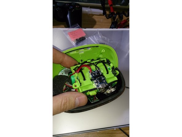

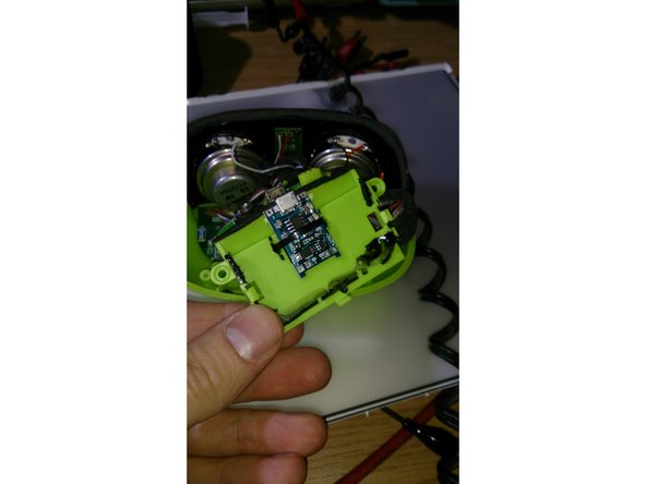

  4. xqisit xqBeat Battery Replacement, new battery charge-controller: crwdns2935265:04crwdnd2935265:01crwdnd2935265:03crwdne2935265:0 xqisit xqBeat Battery Replacement, new battery charge-controller: crwdns2935265:04crwdnd2935265:02crwdnd2935265:03crwdne2935265:0 xqisit xqBeat Battery Replacement, new battery charge-controller: crwdns2935265:04crwdnd2935265:03crwdnd2935265:03crwdne2935265:0
    • there are some reasons, why i chose to use a new battery charge controller
    • 1. I wanted a micro USB port
    • 2. I no longer trust the original one
    • 3. there is place for a new one :)
    • so i made slots for the charger ( it is a liion-battery-charger/protector) to get it centered over the original usb-connector. you can move it back an forth because at this point you dont know the exact position. google it if you wand, they are about a dollar.

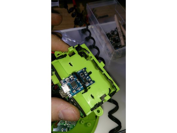

  5. xqisit xqBeat Battery Replacement, mount the charger: crwdns2935265:05crwdnd2935265:01crwdnd2935265:03crwdne2935265:0 xqisit xqBeat Battery Replacement, mount the charger: crwdns2935265:05crwdnd2935265:02crwdnd2935265:03crwdne2935265:0 xqisit xqBeat Battery Replacement, mount the charger: crwdns2935265:05crwdnd2935265:03crwdnd2935265:03crwdne2935265:0
    • i grinded a bit off the front of the circuit-board so the the connector reaches further out.
    • pull the strap close an determine the final position by trial and error. then fix it with hot glue.
    • here i also made 4 slots to mount the new battery with straps an a slot behind the charger to move the board in the build in state.
  6. xqisit xqBeat Battery Replacement, mount the new battery: crwdns2935265:06crwdnd2935265:01crwdnd2935265:03crwdne2935265:0 xqisit xqBeat Battery Replacement, mount the new battery: crwdns2935265:06crwdnd2935265:02crwdnd2935265:03crwdne2935265:0 xqisit xqBeat Battery Replacement, mount the new battery: crwdns2935265:06crwdnd2935265:03crwdnd2935265:03crwdne2935265:0
    • to mount the new battery i used double sided tape and straps.
    • solder the new battery to the b+ and b- points on the charger
    • solder the out+ and out- points to the original battery connections on the board
