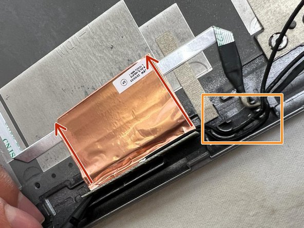

  3. why! L140/1PU right WLAN antenna replacement, Upper frame 1: crwdns2935265:03crwdnd2935265:01crwdnd2935265:03crwdne2935265:0 why! L140/1PU right WLAN antenna replacement, Upper frame 1: crwdns2935265:03crwdnd2935265:02crwdnd2935265:03crwdne2935265:0 why! L140/1PU right WLAN antenna replacement, Upper frame 1: crwdns2935265:03crwdnd2935265:03crwdnd2935265:03crwdne2935265:0
    • The orange squares indicate the zones we will focus on.
    • Unplug the screen cable.
    • Unscrew the screw of the cover and those of the hinge. Remove the cover.

  6. why! L140/1PU right WLAN antenna replacement, Upper frame 4: crwdns2935265:06crwdnd2935265:01crwdnd2935265:03crwdne2935265:0 why! L140/1PU right WLAN antenna replacement, Upper frame 4: crwdns2935265:06crwdnd2935265:02crwdnd2935265:03crwdne2935265:0 why! L140/1PU right WLAN antenna replacement, Upper frame 4: crwdns2935265:06crwdnd2935265:03crwdnd2935265:03crwdne2935265:0
    • Remove the upper case, separating it from the screen.
    • Using a hair dryer, blow hot air around the screen to soften the frame's adhesive.
    • In order to avoid damaging components, never keep the hair dryer aimed at the same spot.

    • Remove the four strips of tape.
  12. why! L140/1PU right WLAN antenna replacement, Screen 2: crwdns2935265:012crwdnd2935265:01crwdnd2935265:03crwdne2935265:0 why! L140/1PU right WLAN antenna replacement, Screen 2: crwdns2935265:012crwdnd2935265:02crwdnd2935265:03crwdne2935265:0 why! L140/1PU right WLAN antenna replacement, Screen 2: crwdns2935265:012crwdnd2935265:03crwdnd2935265:03crwdne2935265:0
    • Using tweezers, grasp and gently pull the tape.
  13. why! L140/1PU right WLAN antenna replacement, Screen 3: crwdns2935265:013crwdnd2935265:01crwdnd2935265:03crwdne2935265:0 why! L140/1PU right WLAN antenna replacement, Screen 3: crwdns2935265:013crwdnd2935265:02crwdnd2935265:03crwdne2935265:0 why! L140/1PU right WLAN antenna replacement, Screen 3: crwdns2935265:013crwdnd2935265:03crwdnd2935265:03crwdne2935265:0
    • Pull the tape until it is freed. Repeat on all 3 other sides.
    • Lift up the screen.

  17. why! L140/1PU right WLAN antenna replacement, Antenna D: crwdns2935265:017crwdnd2935265:01crwdnd2935265:02crwdne2935265:0 why! L140/1PU right WLAN antenna replacement, Antenna D: crwdns2935265:017crwdnd2935265:02crwdnd2935265:02crwdne2935265:0
    • Use the spudger to move the board out of the way.
    • Gently detach the adhesive.
    • Follow the cabling as you remove the antenna.
