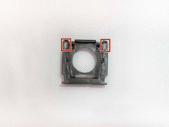

  • There are two (2) grooves on the outer retainer that fit onto two (2) metal brackets on the key's designated space.
  • Use angled tweezers to place the assembled retainer onto the two (2) metal brackets on the keyboard.
