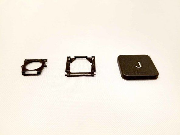

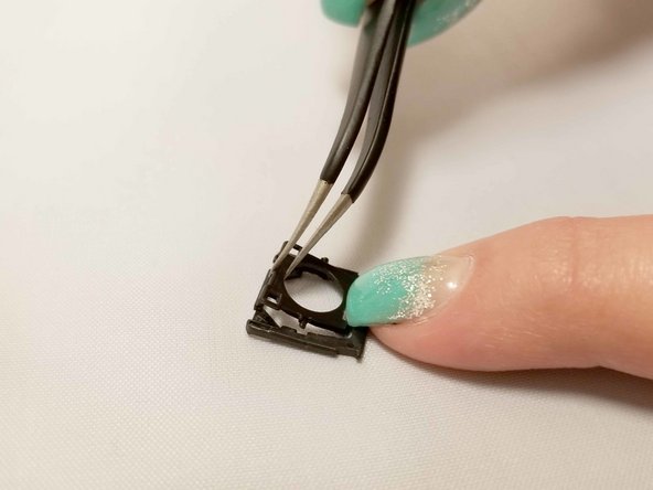

    • There is an outer and inner piece of the retainer. The outer retainer has two (2) grooves for the inner retainer's posts to sit in.
    • Place the inner retainer piece into the outer retainer piece by inserting the posts into the grooves on the outer retainer piece.

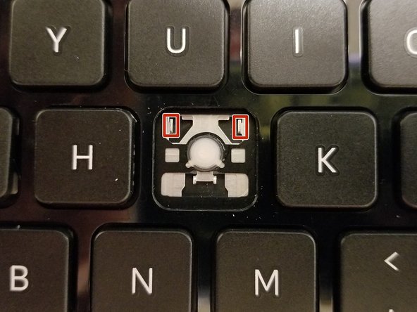

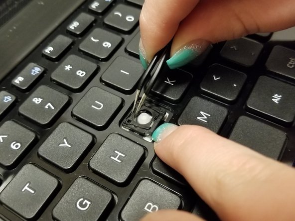

    • There are two (2) grooves on the outer retainer that fit onto two (2) metal brackets on the key's designated space.
    • Use angled tweezers to place the assembled retainer onto the two (2) metal brackets on the keyboard.

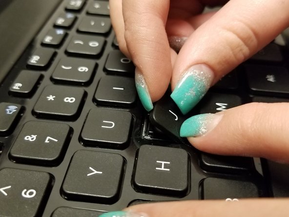

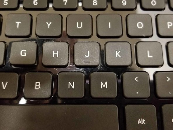

    • Once the retainer is attached, press the key onto the retainer, it will make a snapping sound when in place.
