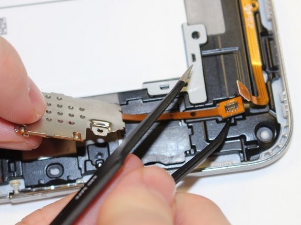

  • Using the plastic end of the tweezers pop up the orange tab connecting the SD port to the device.
  • There is a little indent below the orange tab to help get under this piece. It may be difficult to remove, push up hard.
