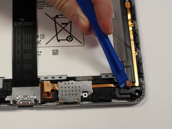

  • Pop open the orange wire tab connected to the SD port with the plastic opening tool.
  • If there is tape covering your tab, remove it with the tweezers before you pop open the tab.
