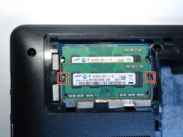

  • Locate the two (2) metal brackets holding the RAM chip in place.
  • Carefully push the brackets outwards away from the RAM chip, causing it to pop out of the brackets.
  • Remove the first RAM chip by pulling it up and out of its plug.
