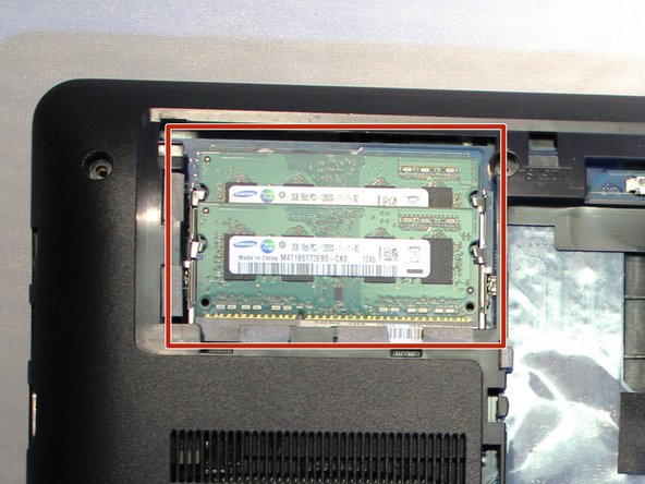

    • Locate the two (2) RAM chips in the upper left corner.
  6. Samsung NP36535C-S05US RAM Replacement: crwdns2935265:06crwdnd2935265:01crwdnd2935265:03crwdne2935265:0 Samsung NP36535C-S05US RAM Replacement: crwdns2935265:06crwdnd2935265:02crwdnd2935265:03crwdne2935265:0 Samsung NP36535C-S05US RAM Replacement: crwdns2935265:06crwdnd2935265:03crwdnd2935265:03crwdne2935265:0

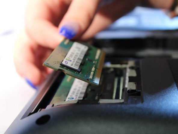

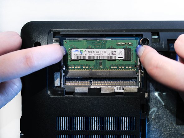

    • Locate the two (2) metal brackets holding the RAM chip in place.
    • Carefully push the brackets outwards away from the RAM chip, causing it to pop out of the brackets.
    • Remove the first RAM chip by pulling it up and out of its plug.
  7. Samsung NP36535C-S05US RAM Replacement: crwdns2935265:07crwdnd2935265:01crwdnd2935265:03crwdne2935265:0 Samsung NP36535C-S05US RAM Replacement: crwdns2935265:07crwdnd2935265:02crwdnd2935265:03crwdne2935265:0 Samsung NP36535C-S05US RAM Replacement: crwdns2935265:07crwdnd2935265:03crwdnd2935265:03crwdne2935265:0

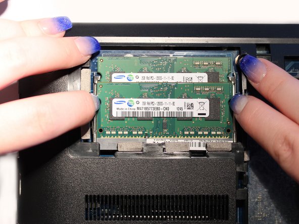

    • Locate the second set of metal brackets holding the remaining RAM chip.
    • Remove the second RAM chip by pulling it up and out of its plug.
  8. Samsung NP36535C-S05US RAM Replacement: crwdns2935265:08crwdnd2935265:01crwdnd2935265:01crwdne2935265:0
    • You have successfully removed the RAM chips.
