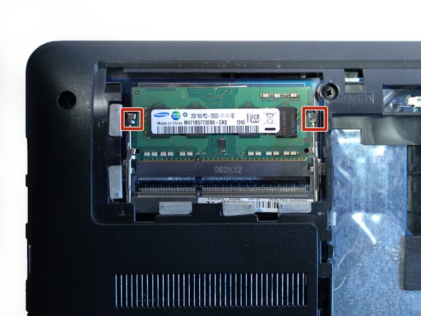

  • Locate the second set of metal brackets holding the remaining RAM chip.
  • Carefully push the brackets outwards away from the RAM chip, causing it to pop out of the brackets.
  • Remove the second RAM chip by pulling it up and out of its plug.
