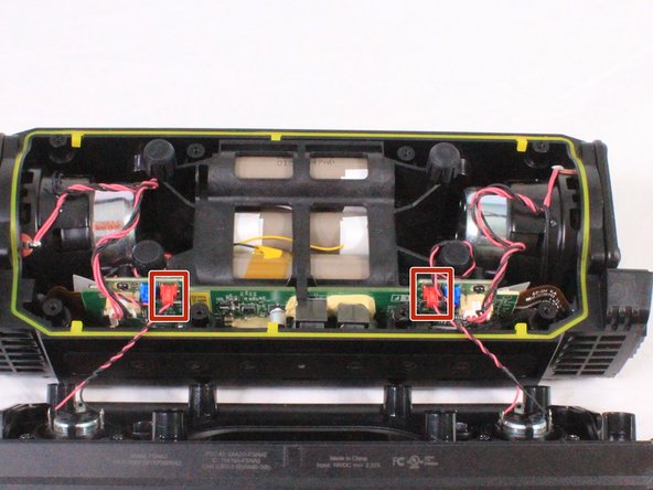

  • Using a pair of tweezers or your hand, carefully remove the red bundled cable connectors from the motherboard.
  • When the red bundled cable connectors are disconnected, set the outer casing aside.
