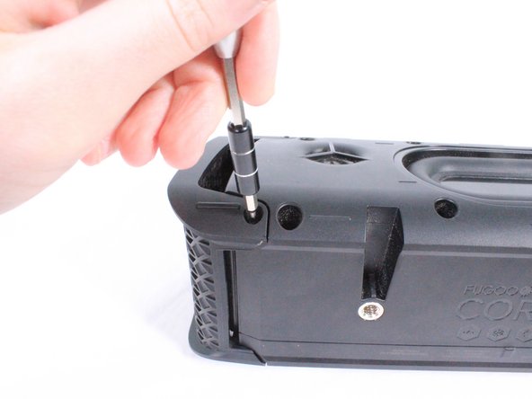

Fugoo Style XL Motherboard Replacement
    1. Fugoo Style XL Motherboard Replacement, Fabric Case: crwdns2935265:01crwdnd2935265:01crwdnd2935265:02crwdne2935265:0 Fugoo Style XL Motherboard Replacement, Fabric Case: crwdns2935265:01crwdnd2935265:02crwdnd2935265:02crwdne2935265:0

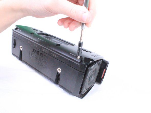

      • Using your hand, unscrew the large screws underneath the speaker.

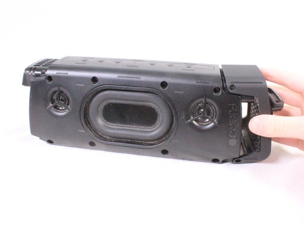

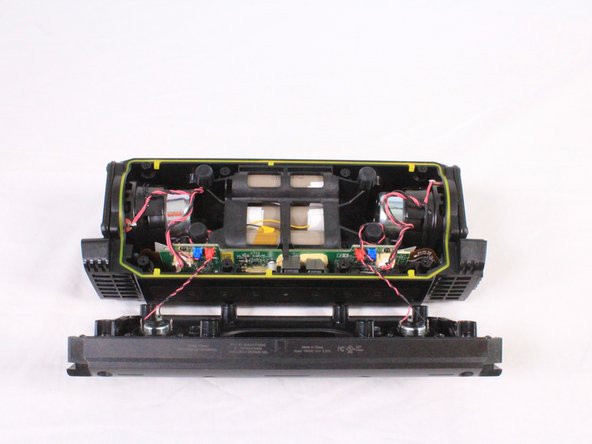

    4. Fugoo Style XL Motherboard Replacement: crwdns2935265:06crwdnd2935265:01crwdnd2935265:02crwdne2935265:0 Fugoo Style XL Motherboard Replacement: crwdns2935265:06crwdnd2935265:02crwdnd2935265:02crwdne2935265:0
      • Gently pull apart the front casing from the back casing.
      • Speakers on the front casing have wires directly connected to the motherboard. Pulling off the casing with force will result in damage.

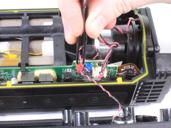

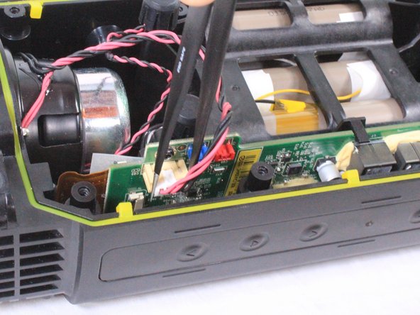

    5. Fugoo Style XL Motherboard Replacement: crwdns2935265:07crwdnd2935265:01crwdnd2935265:02crwdne2935265:0 Fugoo Style XL Motherboard Replacement: crwdns2935265:07crwdnd2935265:02crwdnd2935265:02crwdne2935265:0
      • Using a pair of tweezers or your hand, carefully remove the red bundled cable connectors from the motherboard.
      • When the red bundled cable connectors are disconnected, set the outer casing aside.

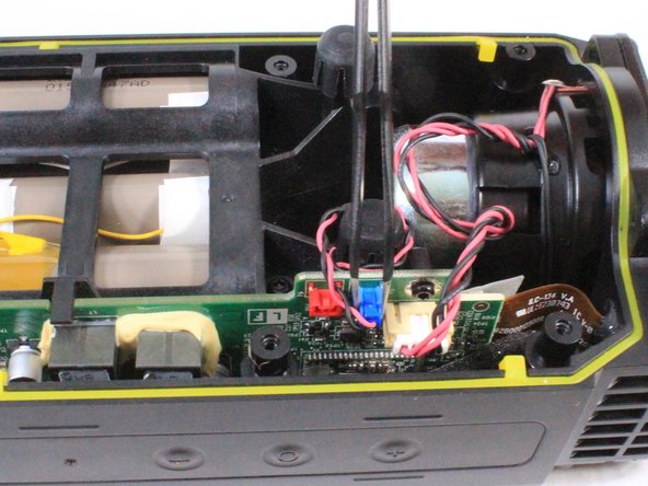

    6. Fugoo Style XL Motherboard Replacement: crwdns2935265:08crwdnd2935265:01crwdnd2935265:02crwdne2935265:0 Fugoo Style XL Motherboard Replacement: crwdns2935265:08crwdnd2935265:02crwdnd2935265:02crwdne2935265:0
      • Untangle any blue bundled cable connectors and gently remove them from the motherboard using a pair of tweezers.
    7. Fugoo Style XL Motherboard Replacement: crwdns2935265:09crwdnd2935265:01crwdnd2935265:02crwdne2935265:0 Fugoo Style XL Motherboard Replacement: crwdns2935265:09crwdnd2935265:02crwdnd2935265:02crwdne2935265:0
      • Carefully untangle and remove the white bundled cable connectors from the motherboard.

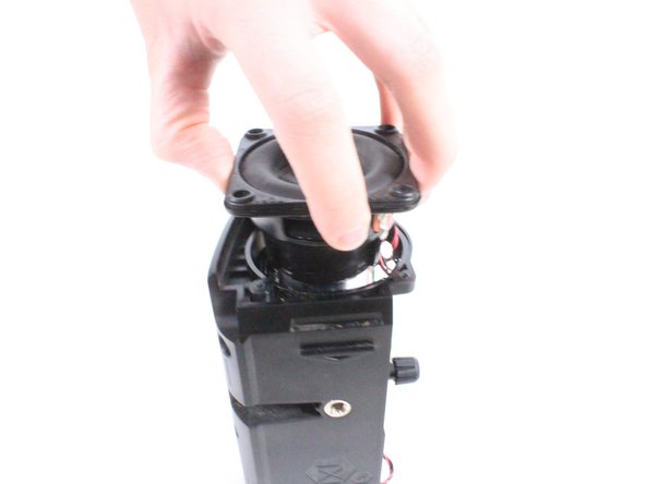

    8. Fugoo Style XL Motherboard Replacement: crwdns2935265:010crwdnd2935265:01crwdnd2935265:02crwdne2935265:0 Fugoo Style XL Motherboard Replacement: crwdns2935265:010crwdnd2935265:02crwdnd2935265:02crwdne2935265:0
      • Using a T9 screwdriver, remove the 8 screws (4 on each speaker) surrounding the midwoofers.
      • Using your hand, carefully remove the midwoofers.

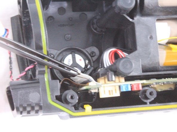

    9. Fugoo Style XL Motherboard Replacement: crwdns2935265:011crwdnd2935265:01crwdnd2935265:02crwdne2935265:0 Fugoo Style XL Motherboard Replacement: crwdns2935265:011crwdnd2935265:02crwdnd2935265:02crwdne2935265:0

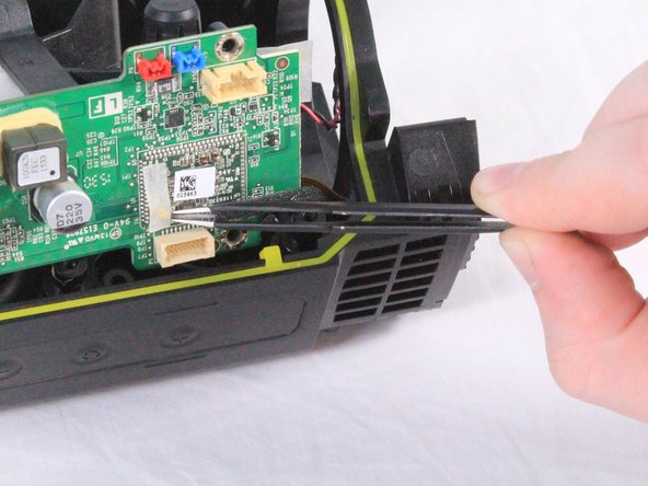

      • Using a pair of tweezers, lift the padded holding that secures the ZIF connector to the motherboard. The connector will release from the motherboard once the padding is lifted.
      • Do not pull on the cables themselves. Doing so can damage the cables. Always remove the ZIF connector by gently lifting the padding securing them to the motherboard.

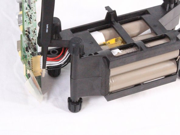

    10. Fugoo Style XL Motherboard Replacement: crwdns2935265:012crwdnd2935265:01crwdnd2935265:02crwdne2935265:0 Fugoo Style XL Motherboard Replacement: crwdns2935265:012crwdnd2935265:02crwdnd2935265:02crwdne2935265:0
      • Carefully lift the battery and motherboard unit halfway out of the casing. The motherboard is connected to the battery directly.
      • There is a small coaxial cable connected underneath the motherboard. Using a pair of tweezers, carefully disconnect and remove the cable from under the adhesive tape.
      • When the cable is disconnected, fully remove the motherboard and battery unit.

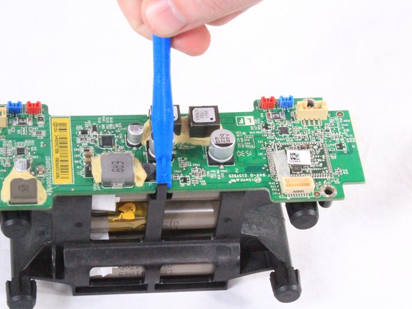

    11. Fugoo Style XL Motherboard Replacement: crwdns2935265:013crwdnd2935265:01crwdnd2935265:02crwdne2935265:0 Fugoo Style XL Motherboard Replacement: crwdns2935265:013crwdnd2935265:02crwdnd2935265:02crwdne2935265:0
      • Remove the 3mm screws using a #2.0 Hex screwdriver. There are 4 of these screws (2 on each side) that connect the motherboard to the battery unit.
      • When the screws are removed, use an iFixit opening tool to remove the motherboard from the two clamps securing it to the battery pack.
      • Beware! The motherboard is not fully disconnected from the battery even when removed from the clamps.
    12. Fugoo Style XL Motherboard Replacement: crwdns2935265:014crwdnd2935265:01crwdnd2935265:02crwdne2935265:0 Fugoo Style XL Motherboard Replacement: crwdns2935265:014crwdnd2935265:02crwdnd2935265:02crwdne2935265:0
      • Using tweezers or your hand, carefully disconnect the bundled cables connecting the battery to the motherboard.
