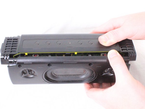

  • Gently pull apart the front casing from the back casing.
  • Speakers on the front casing have wires directly connected to the motherboard. Pulling off the casing with force will result in damage.
