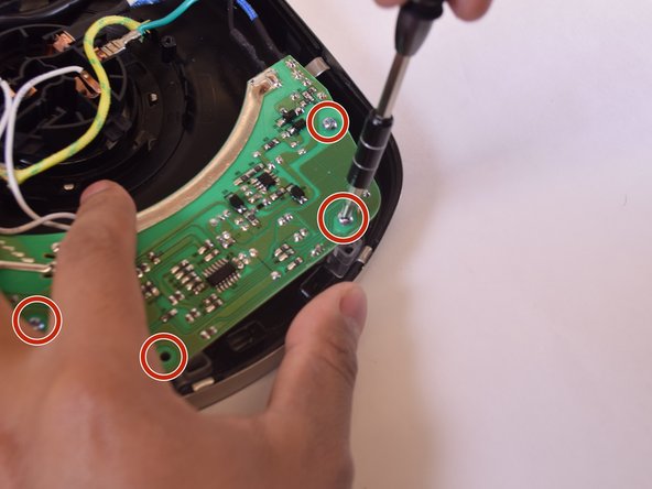

  • Begin detaching the circuit board by removing four rounded top (12mm) Philips head screws (one from each corner).
  • When removing thin metal components, hand protection is recommended to avoid small but painful slices to your fingers.
  • Find the blue and black wires that connect to the circuit board from the power cord. Using moderate force, pull them away from their silver tabs on the circuit board.
