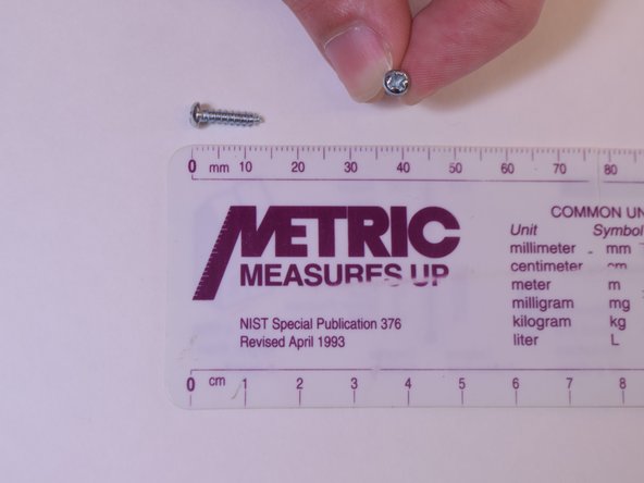

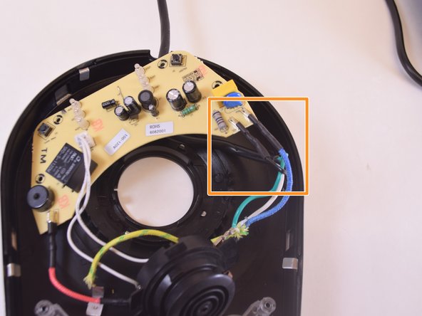

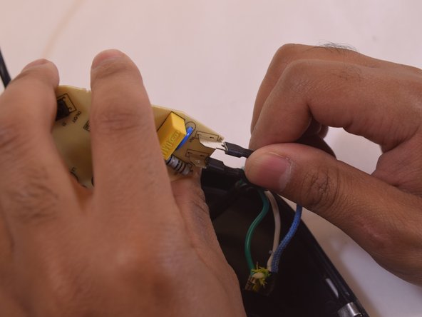

    • Begin detaching the circuit board by removing four rounded top (12mm) Philips head screws (one from each corner).
    • When removing thin metal components, hand protection is recommended to avoid small but painful slices to your fingers.
    • Find the blue and black wires that connect to the circuit board from the power cord. Using moderate force, pull them away from their silver tabs on the circuit board.

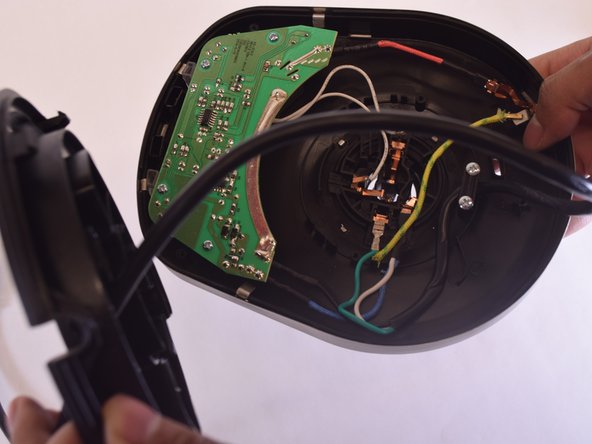

  5. Caribou Coffee CC-EKV8SS7 Power Cord Replacement: crwdns2935265:05crwdnd2935265:01crwdnd2935265:01crwdne2935265:0
    • Detach the power cord's grounding wire (yellow with green stripes) from the edge. First unbend the silver strip, then pull upwards with a small jiggle.
  6. Caribou Coffee CC-EKV8SS7 Power Cord Replacement: crwdns2935265:06crwdnd2935265:01crwdnd2935265:03crwdne2935265:0 Caribou Coffee CC-EKV8SS7 Power Cord Replacement: crwdns2935265:06crwdnd2935265:02crwdnd2935265:03crwdne2935265:0 Caribou Coffee CC-EKV8SS7 Power Cord Replacement: crwdns2935265:06crwdnd2935265:03crwdnd2935265:03crwdne2935265:0

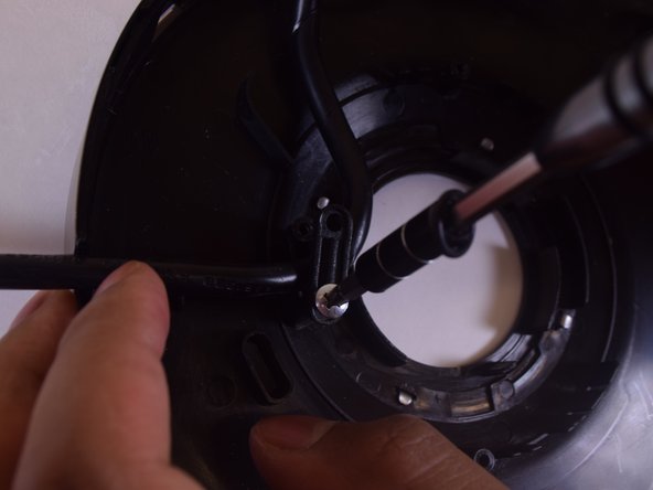

    • Remove the two rounded top (12mm) Phillips Head screws from the 1'' bar holding down the power cord.
  7. Caribou Coffee CC-EKV8SS7 Power Cord Replacement: crwdns2935265:07crwdnd2935265:01crwdnd2935265:03crwdne2935265:0 Caribou Coffee CC-EKV8SS7 Power Cord Replacement: crwdns2935265:07crwdnd2935265:02crwdnd2935265:03crwdne2935265:0 Caribou Coffee CC-EKV8SS7 Power Cord Replacement: crwdns2935265:07crwdnd2935265:03crwdnd2935265:03crwdne2935265:0

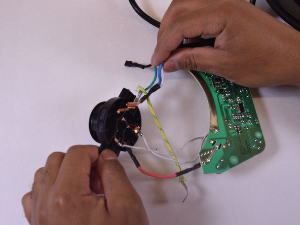

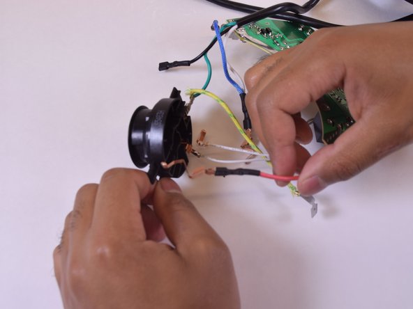

    • Disconnect five metal connectors attached to the center circle - three wires from the circuit board, and two wires from the power cord.
    • From the circuit board, there are two white wires and one red wire to be disconnected.
    • From the power cord, there is a green wire, as well as two wires (one blue, one white) connected with black electrical tape near the metal.
  8. Caribou Coffee CC-EKV8SS7 Power Cord Replacement: crwdns2935265:08crwdnd2935265:01crwdnd2935265:03crwdne2935265:0 Caribou Coffee CC-EKV8SS7 Power Cord Replacement: crwdns2935265:08crwdnd2935265:02crwdnd2935265:03crwdne2935265:0 Caribou Coffee CC-EKV8SS7 Power Cord Replacement: crwdns2935265:08crwdnd2935265:03crwdnd2935265:03crwdne2935265:0

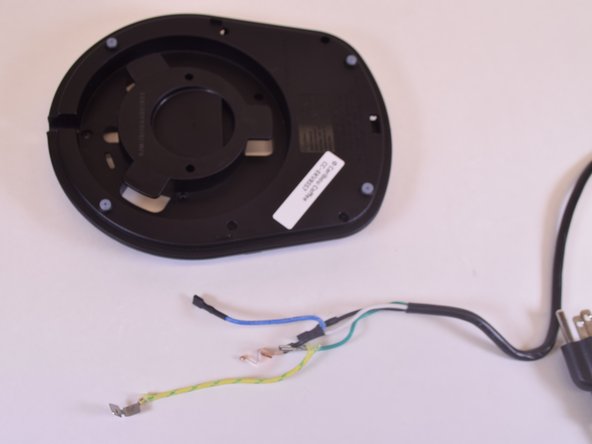

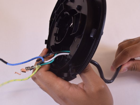

    • At this point, as long as all the color-coded wires at the end are straightened, the power cord can be pulled through the black base bottom.
    • Discard the old power cord and insert the new power cord by following these instructions in reverse.
