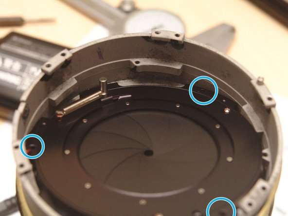

Remove Zoom Fixed Ring
  • Unscrew three outer screws and remove Aperture Blade Unit
  • Do NOT manipulate the Aperture calibration screw! (RED mark)
  • Do NOT manipulate the whatever calibration screw! (YELLOW mark)
  • Remove eight black screws and lift "Zoom Fixed Ring" and "MF Ring"
