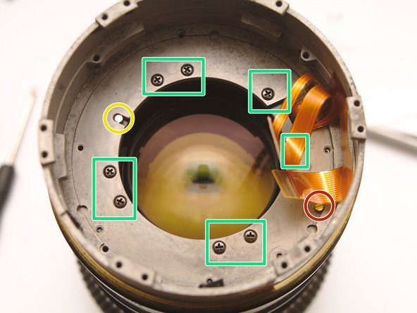

    • Unscrew three outer screws and remove Aperture Blade Unit
    • Do NOT manipulate the Aperture calibration screw! (RED mark)
    • Do NOT manipulate the whatever calibration screw! (YELLOW mark)
    • Remove eight black screws and lift "Zoom Fixed Ring" and "MF Ring"

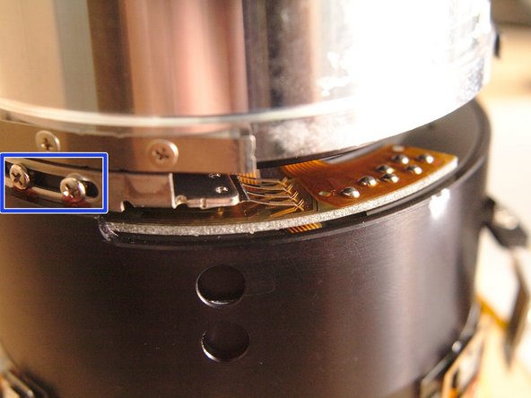

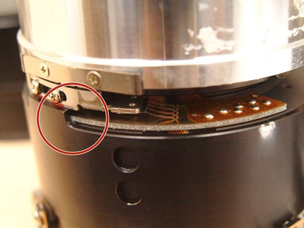

    • Here is the ISSUE. internal focus ring has contact with Distance readout PCB. The PCB is mounted by double sided tape. This is a design flaw. double sided tape drifts over time, and let the PCB slip out.
  6. Solve stuck focus of AF-S VR Zoom-Nikkor ED 70-200mm f/2.8G IF: crwdns2935265:06crwdnd2935265:01crwdnd2935265:03crwdne2935265:0 Solve stuck focus of AF-S VR Zoom-Nikkor ED 70-200mm f/2.8G IF: crwdns2935265:06crwdnd2935265:02crwdnd2935265:03crwdne2935265:0 Solve stuck focus of AF-S VR Zoom-Nikkor ED 70-200mm f/2.8G IF: crwdns2935265:06crwdnd2935265:03crwdnd2935265:03crwdne2935265:0

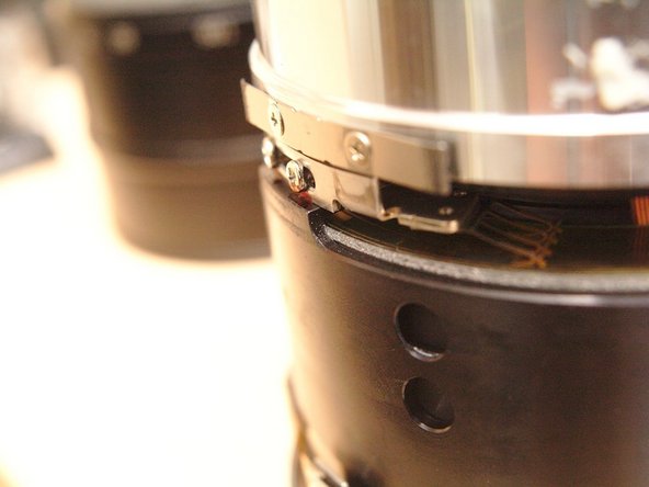

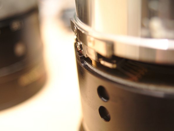

    • More detail. The infinity end is glued using some better glue(dark material), while the close end is NOT.
    • The fix is
    • Mark or remember the position BEFORE removing two screws and contact brush! but relax, this part is not extremely precise.
    • Lift the PCB. Cleanup double sided tape. Glue the PCB back firmly against the inner edge.
    • Use proper glue, like "high viscous super glue" or "2-part epoxy resin". Do NOT use low viscous glue, it will mess up and contaminate the contacts.
