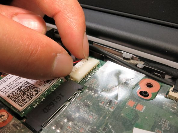

  • Remove the cable at the top left of the motherboard by grabbing the male connector and applying force in the direction of the wires away from the motherboard.
  • Do not pull on the wires to apply more force. Instead, gently wiggle the connector until it slides out.
