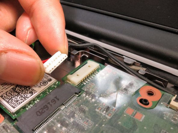

    • Remove the cable at the top left of the motherboard by grabbing the male connector and applying force in the direction of the wires away from the motherboard.
    • Do not pull on the wires to apply more force. Instead, gently wiggle the connector until it slides out.

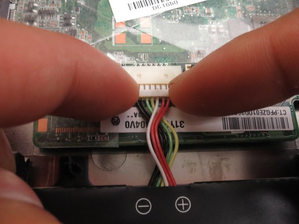

  10. HP Chromebook 11 G4 Motherboard Replacement: crwdns2935265:010crwdnd2935265:01crwdnd2935265:02crwdne2935265:0 HP Chromebook 11 G4 Motherboard Replacement: crwdns2935265:010crwdnd2935265:02crwdnd2935265:02crwdne2935265:0

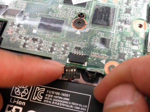

    • Disconnect the battery wires from the motherboard by applying pressure on the male connector away from the motherboard.

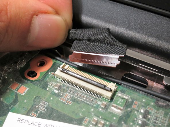

  12. HP Chromebook 11 G4 Motherboard Replacement: crwdns2935265:012crwdnd2935265:01crwdnd2935265:02crwdne2935265:0 HP Chromebook 11 G4 Motherboard Replacement: crwdns2935265:012crwdnd2935265:02crwdnd2935265:02crwdne2935265:0
    • Use a fingernail or a spudger to flip up the black tab on the zero insertion force connector located at the top of the motherboard.
    • Remove the cable by pulling away from the motherboard.

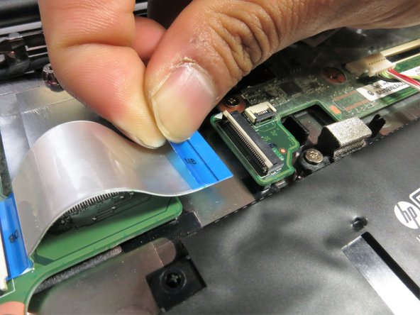

  13. HP Chromebook 11 G4 Motherboard Replacement: crwdns2935265:013crwdnd2935265:01crwdnd2935265:02crwdne2935265:0 HP Chromebook 11 G4 Motherboard Replacement: crwdns2935265:013crwdnd2935265:02crwdnd2935265:02crwdne2935265:0
    • Use a fingernail or a spudger to flip up the white tab on the zero insertion force connector on the bottom left of the motherboard.

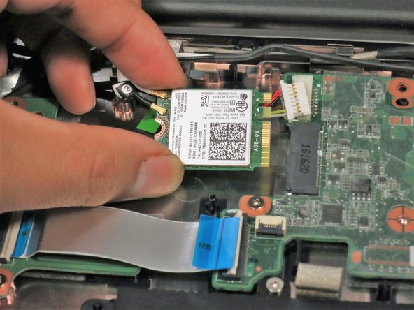

    • Remove the 4 mm Phillips #1 screw on the Wi-Fi card.
  15. HP Chromebook 11 G4 Motherboard Replacement: crwdns2935265:015crwdnd2935265:01crwdnd2935265:02crwdne2935265:0 HP Chromebook 11 G4 Motherboard Replacement: crwdns2935265:015crwdnd2935265:02crwdnd2935265:02crwdne2935265:0
    • Slide the Wi-Fi card away from the motherboard.

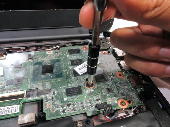

  16. HP Chromebook 11 G4 Motherboard Replacement: crwdns2935265:016crwdnd2935265:01crwdnd2935265:02crwdne2935265:0 HP Chromebook 11 G4 Motherboard Replacement: crwdns2935265:016crwdnd2935265:02crwdnd2935265:02crwdne2935265:0
    • Remove the five 4 mm Phillips #1 screws from the motherboard.
    • One of these screws is black, the rest are silver.

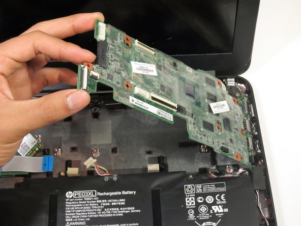

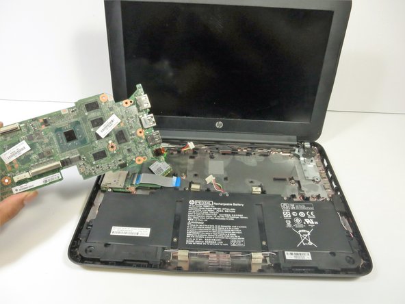

  17. HP Chromebook 11 G4 Motherboard Replacement: crwdns2935265:017crwdnd2935265:01crwdnd2935265:03crwdne2935265:0 HP Chromebook 11 G4 Motherboard Replacement: crwdns2935265:017crwdnd2935265:02crwdnd2935265:03crwdne2935265:0 HP Chromebook 11 G4 Motherboard Replacement: crwdns2935265:017crwdnd2935265:03crwdnd2935265:03crwdne2935265:0
    • Lift the left edge up and away from the base of the laptop.
    • Remove the motherboard.
