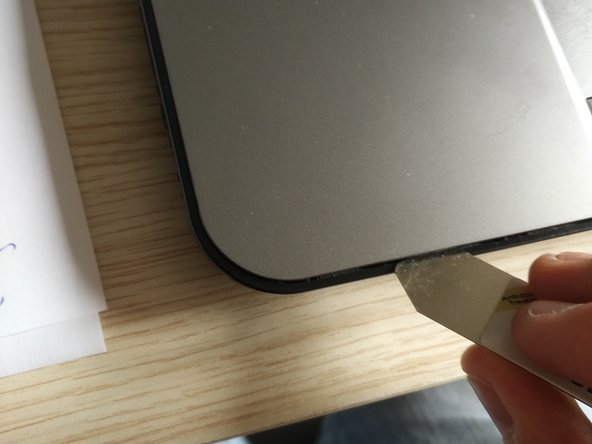

  • Slide your iSesamo around the case as shown in picture 1 and 2, and go around the entire laptop.
  • You will hear clicks after using the iSesamo.
  • Lift the upper plate to reveal the motherboard.
