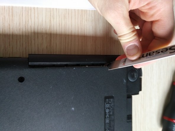

    • Remove the battery.

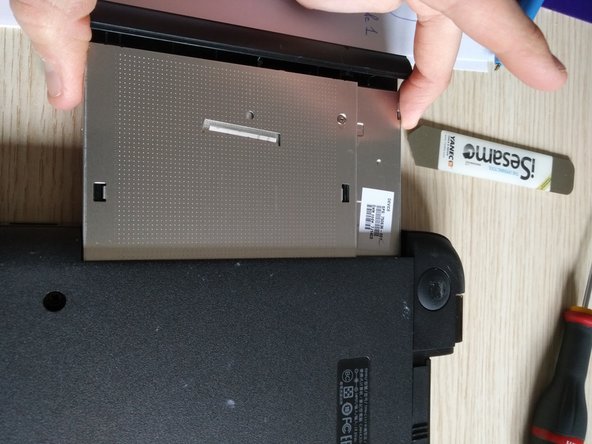

    • Use a #1 Philips driver to remove the disc drive's screw.
    • Using a spudger, gently pry the drive out of the housing.

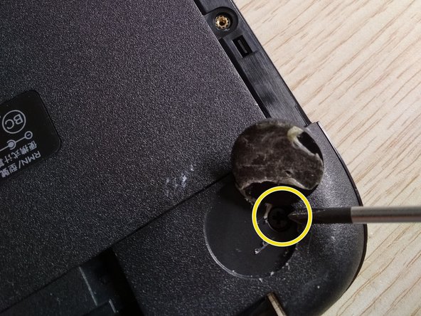

  4. HP 250 G3 WiFi Card Replacement, screws of the case 1: crwdns2935265:04crwdnd2935265:01crwdnd2935265:03crwdne2935265:0 HP 250 G3 WiFi Card Replacement, screws of the case 1: crwdns2935265:04crwdnd2935265:02crwdnd2935265:03crwdne2935265:0 HP 250 G3 WiFi Card Replacement, screws of the case 1: crwdns2935265:04crwdnd2935265:03crwdnd2935265:03crwdne2935265:0

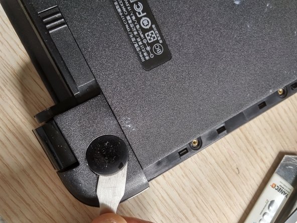

    • Remove the rubber rests on the rear of the device, which are close to the battery.
    • Remove the hidden screws placed under the rests using a #1 Philips driver.

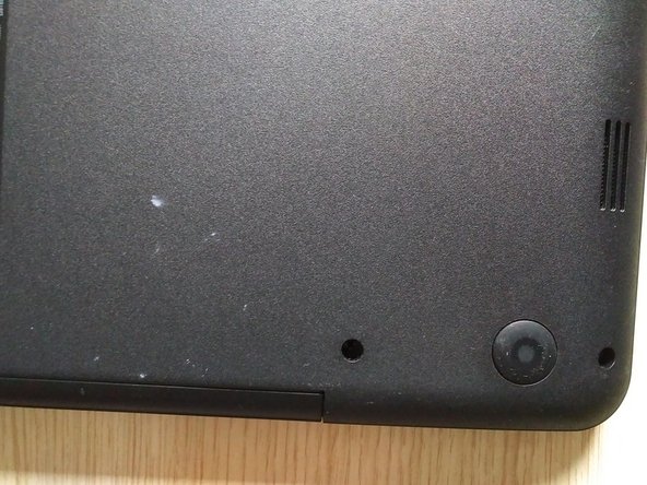

  5. HP 250 G3 WiFi Card Replacement, screws of the case 2: crwdns2935265:05crwdnd2935265:01crwdnd2935265:03crwdne2935265:0 HP 250 G3 WiFi Card Replacement, screws of the case 2: crwdns2935265:05crwdnd2935265:02crwdnd2935265:03crwdne2935265:0 HP 250 G3 WiFi Card Replacement, screws of the case 2: crwdns2935265:05crwdnd2935265:03crwdnd2935265:03crwdne2935265:0
    • Remove the remaining screws on the bottom of the device.
    • Remove the two little screws at the DVD entrance.

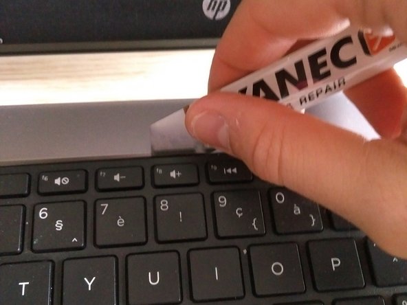

  6. HP 250 G3 WiFi Card Replacement, removing keyboard: crwdns2935265:07crwdnd2935265:01crwdnd2935265:03crwdne2935265:0 HP 250 G3 WiFi Card Replacement, removing keyboard: crwdns2935265:07crwdnd2935265:02crwdnd2935265:03crwdne2935265:0 HP 250 G3 WiFi Card Replacement, removing keyboard: crwdns2935265:07crwdnd2935265:03crwdnd2935265:03crwdne2935265:0
    • Turn the laptop around.
    • Open up the laptop (to remove the keyboard).
    • Use a spudger or iSesamo to remove the keyboard.
    • Slide the iSesamo around the upper side of the keyboard as shown in the pictures (you will hear clicks).
  7. HP 250 G3 WiFi Card Replacement: crwdns2935265:08crwdnd2935265:01crwdnd2935265:03crwdne2935265:0 HP 250 G3 WiFi Card Replacement: crwdns2935265:08crwdnd2935265:02crwdnd2935265:03crwdne2935265:0 HP 250 G3 WiFi Card Replacement: crwdns2935265:08crwdnd2935265:03crwdnd2935265:03crwdne2935265:0
    • When it becomes loose, gently slide the keyboard to the left as shown in the third picture.
    • Be gentle as the thin ribbon can easily tear.

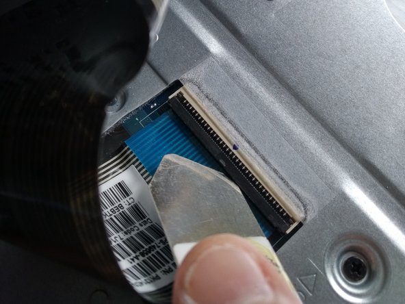

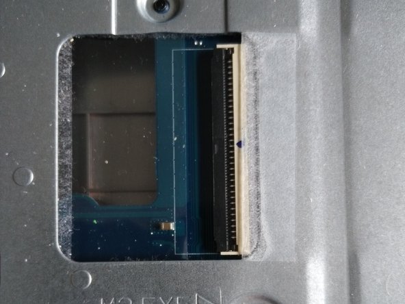

  9. HP 250 G3 WiFi Card Replacement, removing upper plate/case: crwdns2935265:010crwdnd2935265:01crwdnd2935265:03crwdne2935265:0 HP 250 G3 WiFi Card Replacement, removing upper plate/case: crwdns2935265:010crwdnd2935265:02crwdnd2935265:03crwdne2935265:0 HP 250 G3 WiFi Card Replacement, removing upper plate/case: crwdns2935265:010crwdnd2935265:03crwdnd2935265:03crwdne2935265:0
    • Remove the screw circled in the second picture.
    • Remove the tape over the cable and the connector.
    • Remove the white ribbon cable from the connector.
    • Open up the lid with a spudger, and gently remove the ribbon cable.
    • Use caution, as the ribbon cable is pasted to the plate.
    • This ribbon cable is the connector from the ON/OFF switch.

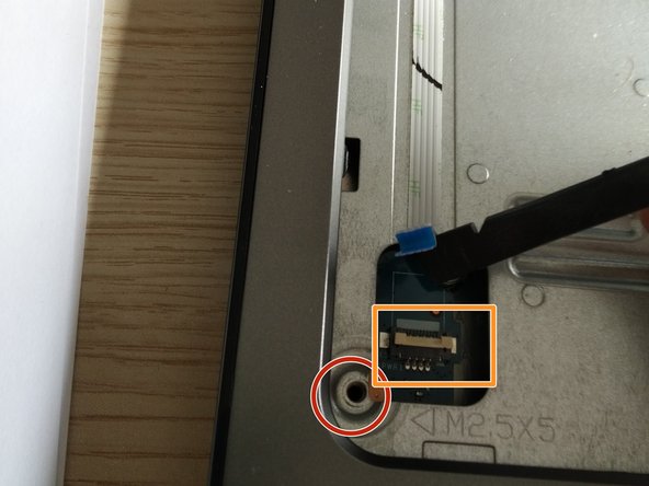

  10. HP 250 G3 WiFi Card Replacement: crwdns2935265:011crwdnd2935265:01crwdnd2935265:02crwdne2935265:0 HP 250 G3 WiFi Card Replacement: crwdns2935265:011crwdnd2935265:02crwdnd2935265:02crwdne2935265:0
    • Remove the circled screw.
    • Remove the ribbon cable from the connector.
    • The ribbon cable/connector is the touch pad/mouse connector.

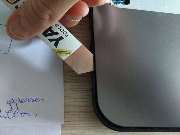

  12. HP 250 G3 WiFi Card Replacement: crwdns2935265:014crwdnd2935265:01crwdnd2935265:03crwdne2935265:0 HP 250 G3 WiFi Card Replacement: crwdns2935265:014crwdnd2935265:02crwdnd2935265:03crwdne2935265:0 HP 250 G3 WiFi Card Replacement: crwdns2935265:014crwdnd2935265:03crwdnd2935265:03crwdne2935265:0
    • Slide your iSesamo around the case as shown in picture 1 and 2, and go around the entire laptop.
    • You will hear clicks after using the iSesamo.
    • Lift the upper plate to reveal the motherboard.

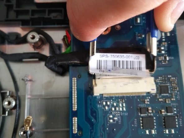

  15. HP 250 G3 WiFi Card Replacement, removing LCD cable: crwdns2935265:017crwdnd2935265:01crwdnd2935265:03crwdne2935265:0 HP 250 G3 WiFi Card Replacement, removing LCD cable: crwdns2935265:017crwdnd2935265:02crwdnd2935265:03crwdne2935265:0 HP 250 G3 WiFi Card Replacement, removing LCD cable: crwdns2935265:017crwdnd2935265:03crwdnd2935265:03crwdne2935265:0
    • Use a spudger to remove the tape/sticker.
    • Be very gentle as the connector is a hard-to-remove ribbon cable with several small cables. Ripping one of them will damage the ribbon cable, and will thereby damage the screen.
    • It is recommended to use an IC extractor to remove the LCD connector (however, you can use two small flathead screwdrivers or tweezers to slide the connector out of the socket).

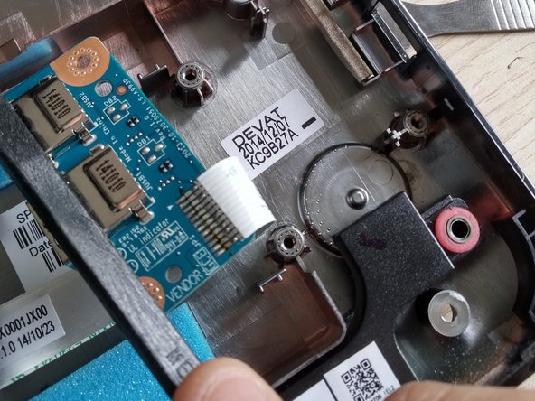

  17. HP 250 G3 WiFi Card Replacement, removing usb pcb: crwdns2935265:019crwdnd2935265:01crwdnd2935265:03crwdne2935265:0 HP 250 G3 WiFi Card Replacement, removing usb pcb: crwdns2935265:019crwdnd2935265:02crwdnd2935265:03crwdne2935265:0 HP 250 G3 WiFi Card Replacement, removing usb pcb: crwdns2935265:019crwdnd2935265:03crwdnd2935265:03crwdne2935265:0
    • Use a spudger to loosen the cable from the bottom plate.
    • The flat ribbon cable is pasted to the bottom plate, and the ribbon cable is soldered to the PCB.

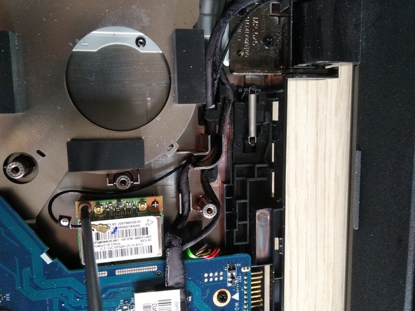

  18. HP 250 G3 WiFi Card Replacement, removing the bad Wifi module.: crwdns2935265:020crwdnd2935265:01crwdnd2935265:03crwdne2935265:0 HP 250 G3 WiFi Card Replacement, removing the bad Wifi module.: crwdns2935265:020crwdnd2935265:02crwdnd2935265:03crwdne2935265:0 HP 250 G3 WiFi Card Replacement, removing the bad Wifi module.: crwdns2935265:020crwdnd2935265:03crwdnd2935265:03crwdne2935265:0
    • Remove the golden antenna cable from the socket. Be very careful, and use a spudger.
    • Remove the screw.
    • The WiFi module will jump up when the screw is removed. Slide the WiFi module out.
    • Wear gloves to avoid touching the antenna or the antenna sockets.
    • To install the new Wifi module, slide the new WiFi module in, push it down, and drive the screw back in.
    • Reattach the antenna.
