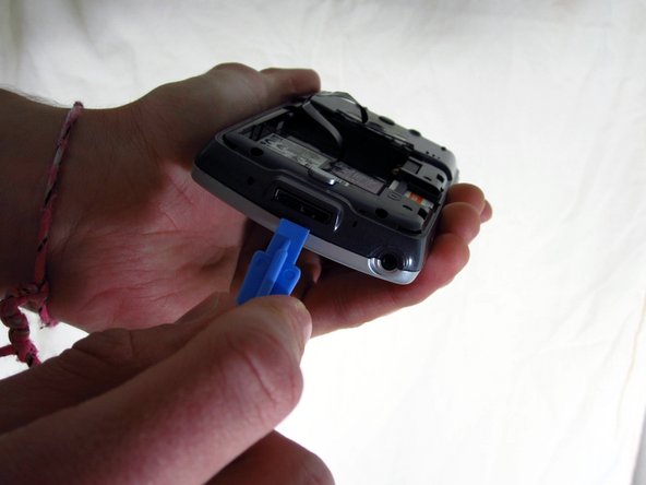

  • Use the plastic opening tool to pry apart the covers along the bottom of the phone.
  • Slide the plastic opening tool along the seam until the two halves of the case separate.
