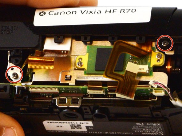

  • Locate and remove the two 3mm Phillips #00 screws on the side of the camera where the side panel was removed.
