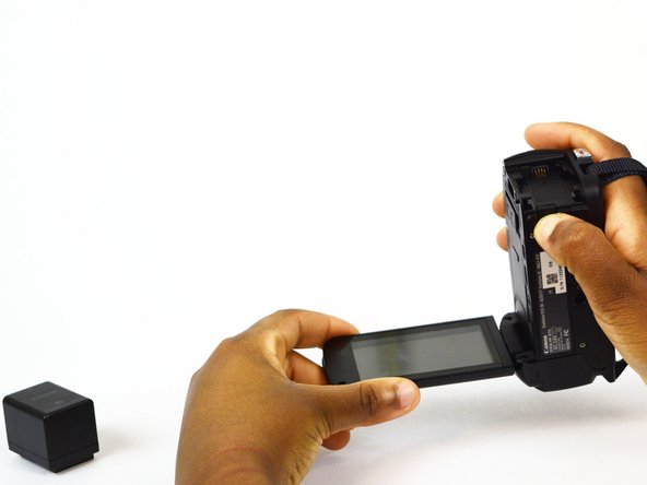

    • Power off and unplug the device.
    • Position the camera so that the battery is facing you.
  2. Canon Vixia HF R70 Top Panel Replacement: crwdns2935265:02crwdnd2935265:01crwdnd2935265:01crwdne2935265:0
    • Locate the latch on the bottom edge of the camera.
    • Hold the battery into place and gently push down on the latch towards the lens.
  3. Canon Vixia HF R70 Top Panel Replacement: crwdns2935265:03crwdnd2935265:01crwdnd2935265:02crwdne2935265:0 Canon Vixia HF R70 Top Panel Replacement: crwdns2935265:03crwdnd2935265:02crwdnd2935265:02crwdne2935265:0
    • While holding down the latch, remove the battery by pulling it out of the device.

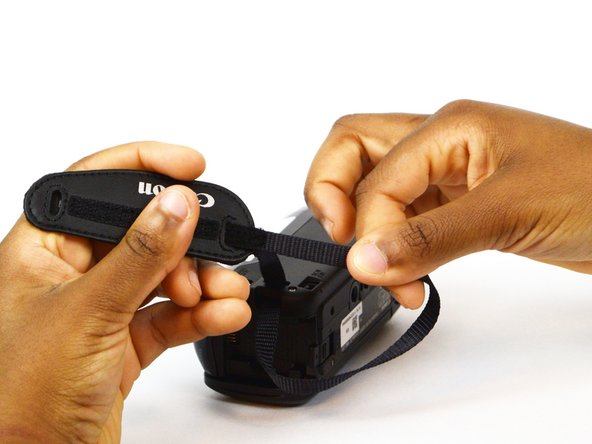

  4. Canon Vixia HF R70 Top Panel Replacement, Wrist Strap: crwdns2935265:04crwdnd2935265:01crwdnd2935265:01crwdne2935265:0
    • Position the camcorder so that the wrist strap is facing you.
    • Locate the loose end of the strap.
  5. Canon Vixia HF R70 Top Panel Replacement: crwdns2935265:05crwdnd2935265:01crwdnd2935265:01crwdne2935265:0
    • Gently pull on the loose end to separate the Velcro.
  6. Canon Vixia HF R70 Top Panel Replacement: crwdns2935265:06crwdnd2935265:01crwdnd2935265:01crwdne2935265:0
    • Locate the "slot" on bottom right corner of the camcorder where the strap loops through.
    • Pull the strap through the loop.
  7. Canon Vixia HF R70 Top Panel Replacement: crwdns2935265:07crwdnd2935265:01crwdnd2935265:02crwdne2935265:0 Canon Vixia HF R70 Top Panel Replacement: crwdns2935265:07crwdnd2935265:02crwdnd2935265:02crwdne2935265:0
    • Pull the strap through the leather cushion.
  8. Canon Vixia HF R70 Top Panel Replacement: crwdns2935265:08crwdnd2935265:01crwdnd2935265:01crwdne2935265:0
    • Pull the strap through the slot on the left side of the camcorder.

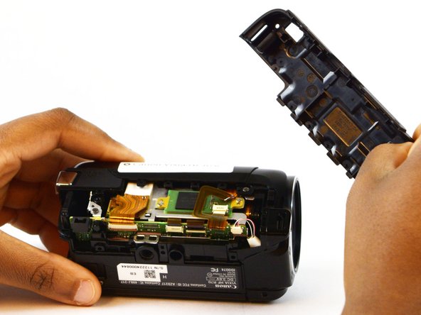

  9. Canon Vixia HF R70 Top Panel Replacement, Side Panel: crwdns2935265:09crwdnd2935265:01crwdnd2935265:02crwdne2935265:0 Canon Vixia HF R70 Top Panel Replacement, Side Panel: crwdns2935265:09crwdnd2935265:02crwdnd2935265:02crwdne2935265:0

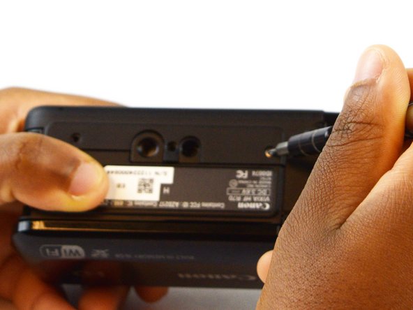

    • Position the camcorder so that the side panel is facing you.
    • Locate the two 6mm Phillips #00 screws on the side panel.
    • Remove the the screws using a screwdriver with a Phillips #00 head.

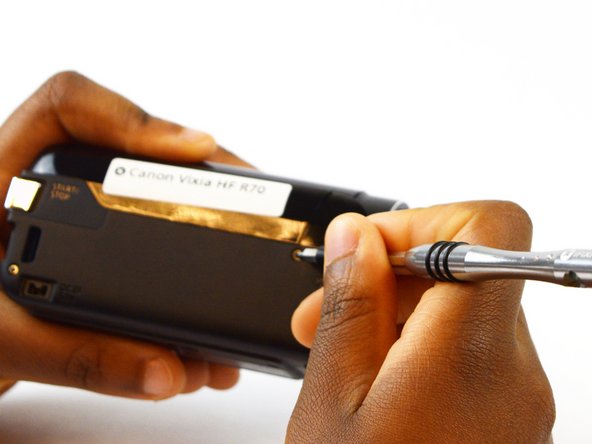

  10. Canon Vixia HF R70 Top Panel Replacement: crwdns2935265:010crwdnd2935265:01crwdnd2935265:03crwdne2935265:0 Canon Vixia HF R70 Top Panel Replacement: crwdns2935265:010crwdnd2935265:02crwdnd2935265:03crwdne2935265:0 Canon Vixia HF R70 Top Panel Replacement: crwdns2935265:010crwdnd2935265:03crwdnd2935265:03crwdne2935265:0
    • Turn the camcorder so that the bottom is facing you.
    • Using your screwdriver, locate and remove the four 6mm Phillips #00 screws connecting the side panel to the bottom of the camcorder.

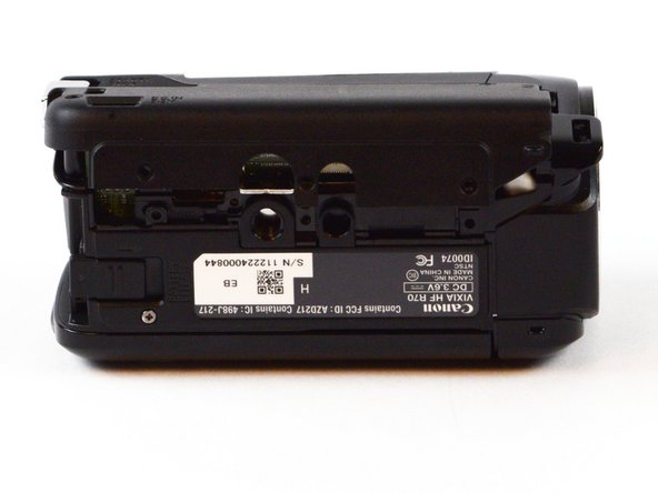

  11. Canon Vixia HF R70 Top Panel Replacement: crwdns2935265:011crwdnd2935265:01crwdnd2935265:02crwdne2935265:0 Canon Vixia HF R70 Top Panel Replacement: crwdns2935265:011crwdnd2935265:02crwdnd2935265:02crwdne2935265:0
    • Gently remove the side panel by pushing it up from the bottom.

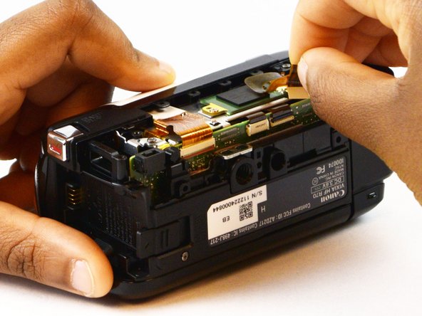

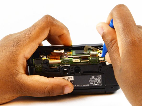

  12. Canon Vixia HF R70 Top Panel Replacement, Top Panel: crwdns2935265:012crwdnd2935265:01crwdnd2935265:02crwdne2935265:0 Canon Vixia HF R70 Top Panel Replacement, Top Panel: crwdns2935265:012crwdnd2935265:02crwdnd2935265:02crwdne2935265:0
    • Disconnect the wires by inserting the plastic opening tool into the small slit.
    • Begin to push upward with the plastic opening tool, disconnecting the two compartments.

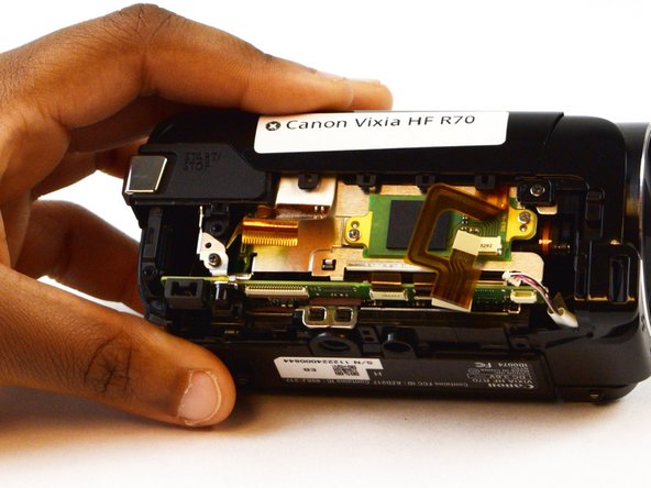

  13. Canon Vixia HF R70 Top Panel Replacement: crwdns2935265:013crwdnd2935265:01crwdnd2935265:03crwdne2935265:0 Canon Vixia HF R70 Top Panel Replacement: crwdns2935265:013crwdnd2935265:02crwdnd2935265:03crwdne2935265:0 Canon Vixia HF R70 Top Panel Replacement: crwdns2935265:013crwdnd2935265:03crwdnd2935265:03crwdne2935265:0
    • Disconnect the four ZIF connectors by grasping the connector firmly and pulling gently.

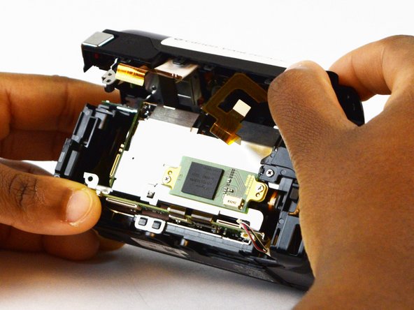

    • Turn the camera over to the side with the LCD screen, and open the screen.

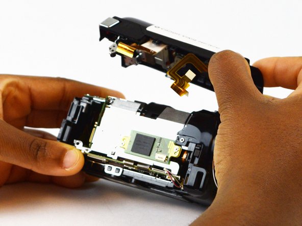

    • Locate and remove the three 5mm Phillips #00 screws holding the top panel in place.
  16. Canon Vixia HF R70 Top Panel Replacement: crwdns2935265:016crwdnd2935265:01crwdnd2935265:03crwdne2935265:0 Canon Vixia HF R70 Top Panel Replacement: crwdns2935265:016crwdnd2935265:02crwdnd2935265:03crwdne2935265:0 Canon Vixia HF R70 Top Panel Replacement: crwdns2935265:016crwdnd2935265:03crwdnd2935265:03crwdne2935265:0
    • Pull the panel up and away until it is removed completely.
