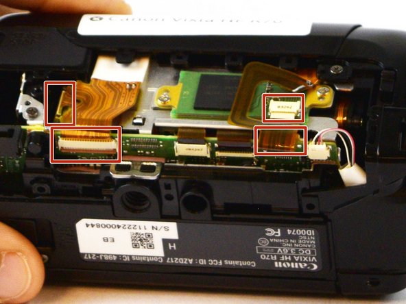

  • Disconnect the four ZIF connectors by grasping the connector firmly and pulling gently.
