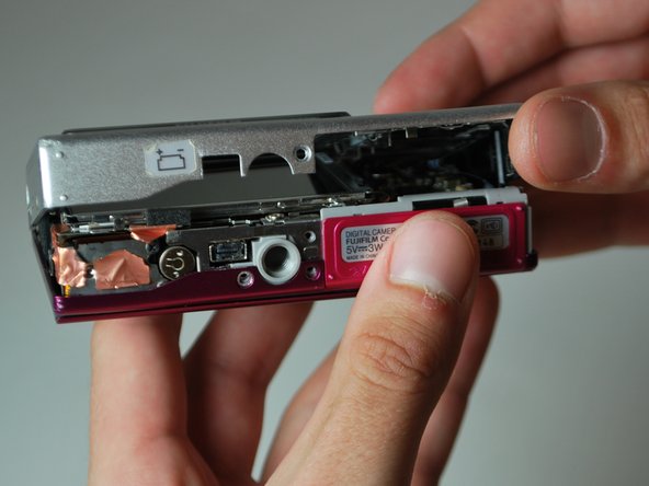

  • Remove the back by carefully flipping it open to the right side.
  • There will be a ribbon cable attaching the front panel to the motherboard, be sure not to tear this.
