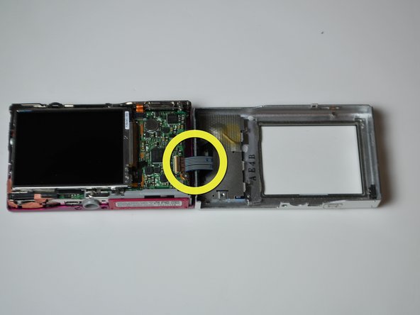

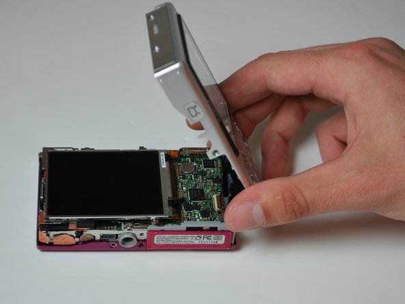

      • Remove the back by carefully flipping it open to the right side.
      • There will be a ribbon cable attaching the front panel to the motherboard, be sure not to tear this.

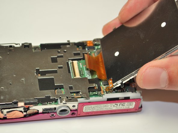

      • Pull the LCD screen to the left slightly, lift it and flip it open to the right.
      • There is also a ribbon cable attaching the LCD screen to the motherboard, be careful not to tear it.

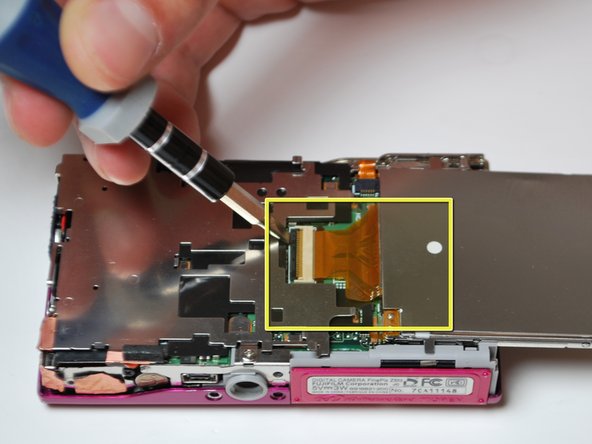

    5. Fujifilm FinePix Z5 LCD Screen Replacement: crwdns2935265:05crwdnd2935265:01crwdnd2935265:02crwdne2935265:0 Fujifilm FinePix Z5 LCD Screen Replacement: crwdns2935265:05crwdnd2935265:02crwdnd2935265:02crwdne2935265:0
      • Using a small flat head screw driver, flip open the black lever to release the ribbon cable.
      • Gently slide the cable out of the lock; the LCD screen is now free to be removed.
    6. Fujifilm FinePix Z5 LCD Screen Replacement: crwdns2935265:06crwdnd2935265:01crwdnd2935265:01crwdne2935265:0
      • Using your index finger, guide the cable of the new screen into place. Lock it in by pushing the black lever back down.
