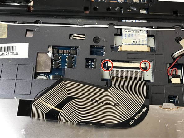

  • The keyboard ribbon is shown after removing the keyboard. There are two tabs holding the ribbon in place as shown.
  • Using your fingers, pull the tabs towards you to release the ribbon from its casing.
