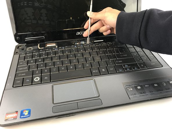

    • Using a metal spudger, pry open the top panel of the device as shown.
  3. Acer Aspire 5517-1127 Keyboard Replacement: crwdns2935265:03crwdnd2935265:01crwdnd2935265:03crwdne2935265:0 Acer Aspire 5517-1127 Keyboard Replacement: crwdns2935265:03crwdnd2935265:02crwdnd2935265:03crwdne2935265:0 Acer Aspire 5517-1127 Keyboard Replacement: crwdns2935265:03crwdnd2935265:03crwdnd2935265:03crwdne2935265:0
    • With the top panel remove, use the spudger to lift the keyboard out of the device as shown.

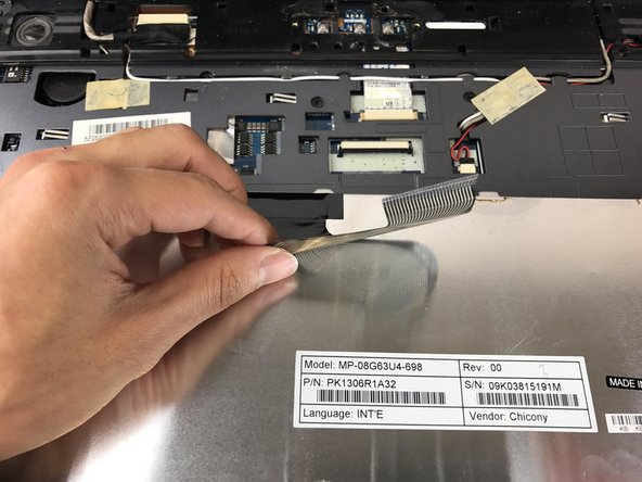

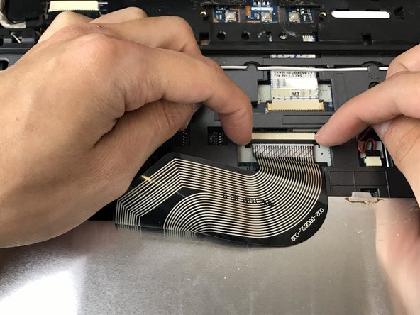

    • The keyboard ribbon is shown after removing the keyboard. There are two tabs holding the ribbon in place as shown.
    • Using your fingers, pull the tabs towards you to release the ribbon from its casing.
