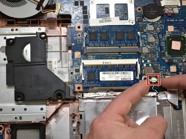

  • Locate the black and white cable connected to the speaker, and slide it toward you, out of its port.
  • Lift up a small portion of the foil tape, and remove the cable from underneath.
  • Your speaker is now removed, and ready to be replaced.
