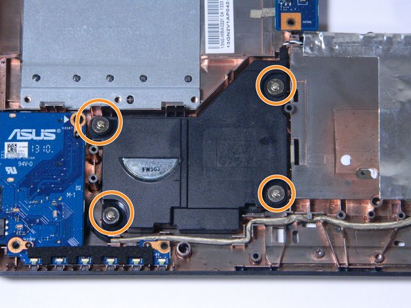

  9. ASUS ROG G75VX-BHI7N11 Speakers Replacement, Speakers: crwdns2935265:09crwdnd2935265:01crwdnd2935265:02crwdne2935265:0 ASUS ROG G75VX-BHI7N11 Speakers Replacement, Speakers: crwdns2935265:09crwdnd2935265:02crwdnd2935265:02crwdne2935265:0
    • Locate the black speakers located in the bottom corner of the laptop near the foil.
    • Remove the four screws holding the speakers in.
  10. ASUS ROG G75VX-BHI7N11 Speakers Replacement: crwdns2935265:010crwdnd2935265:01crwdnd2935265:02crwdne2935265:0 ASUS ROG G75VX-BHI7N11 Speakers Replacement: crwdns2935265:010crwdnd2935265:02crwdnd2935265:02crwdne2935265:0

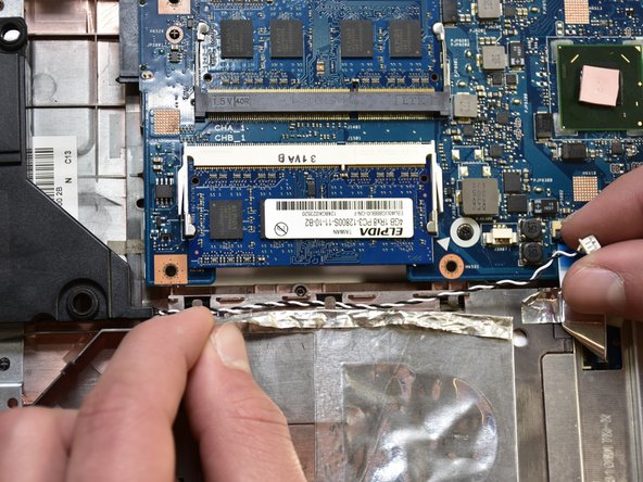

    • Locate the black and white cable connected to the speaker, and slide it toward you, out of its port.
    • Lift up a small portion of the foil tape, and remove the cable from underneath.
    • Your speaker is now removed, and ready to be replaced.
