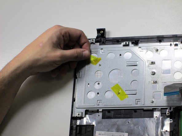

  • Separate the top panel from the rest of the laptop.
  • Remove the yellow tape and then remove the three 1.4 x 2 mm Phillips #00 screws with a Phillips #00 screwdriver.
