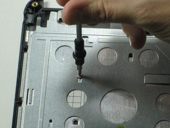

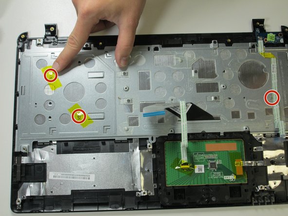

    • Remove the yellow tape and then remove the three 1.4 x 2 mm Phillips #00 screws with a Phillips #00 screwdriver.
  13. ACER Aspire E1-572-6870 Keyboard Replacement: crwdns2935265:013crwdnd2935265:01crwdnd2935265:03crwdne2935265:0 ACER Aspire E1-572-6870 Keyboard Replacement: crwdns2935265:013crwdnd2935265:02crwdnd2935265:03crwdne2935265:0 ACER Aspire E1-572-6870 Keyboard Replacement: crwdns2935265:013crwdnd2935265:03crwdnd2935265:03crwdne2935265:0

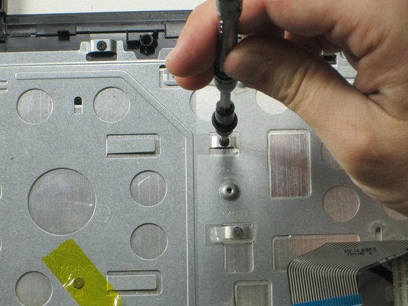

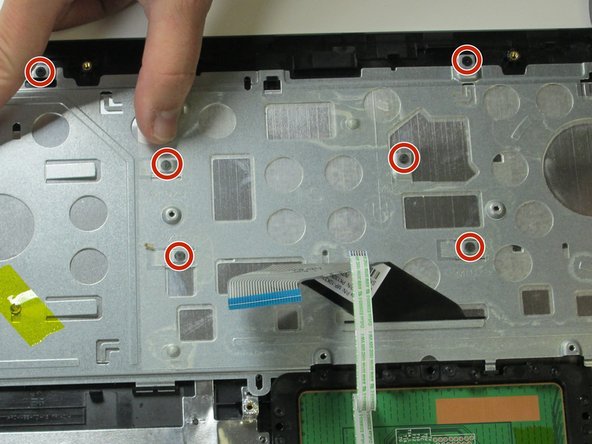

    • Remove the clear tape and then, remove the six 1.6 x 3 mm Phillips #0 screws with a Phillips #0 screwdriver.
  14. ACER Aspire E1-572-6870 Keyboard Replacement: crwdns2935265:014crwdnd2935265:01crwdnd2935265:03crwdne2935265:0 ACER Aspire E1-572-6870 Keyboard Replacement: crwdns2935265:014crwdnd2935265:02crwdnd2935265:03crwdne2935265:0 ACER Aspire E1-572-6870 Keyboard Replacement: crwdns2935265:014crwdnd2935265:03crwdnd2935265:03crwdne2935265:0

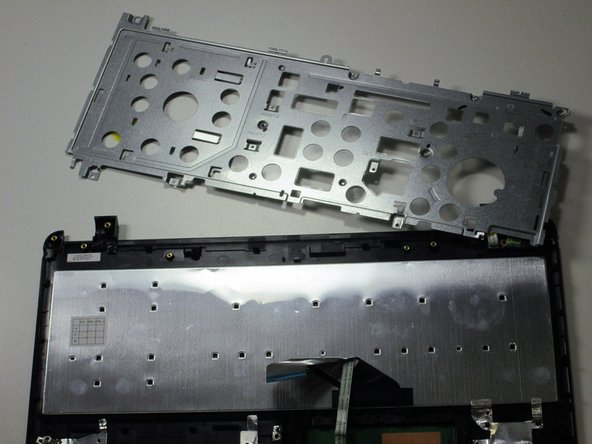

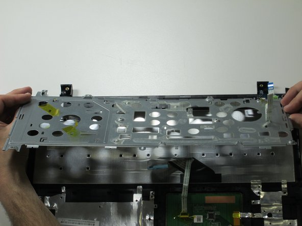

    • Once the screws have all been removed, use a plastic opening tool to slide the metal panel upward on both sides to disengage the metal tabs.
    • Flip the metal panel out once this is done.
  15. ACER Aspire E1-572-6870 Keyboard Replacement: crwdns2935265:015crwdnd2935265:01crwdnd2935265:03crwdne2935265:0 ACER Aspire E1-572-6870 Keyboard Replacement: crwdns2935265:015crwdnd2935265:02crwdnd2935265:03crwdne2935265:0 ACER Aspire E1-572-6870 Keyboard Replacement: crwdns2935265:015crwdnd2935265:03crwdnd2935265:03crwdne2935265:0

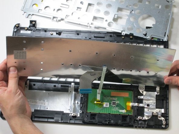

    • Flip panel towards you to take out keyboard.

If installing a new keyboard, remember to pull the keyboard cable through the metal panel before screwing it back in.
