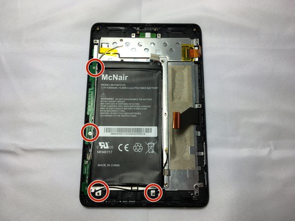

  • After you remove the motherboard, remove the other two boards by unscrewing the 4 screws with a Phillips #00 screwdriver.
  • The screws shown in the picture are the more common 4.76 mm.
  • Remove the tape section of the sheet metal plate with the flat end of a spudger.
  • This might cause damage to your device. Be very careful when scrapping the plate off of the device.
