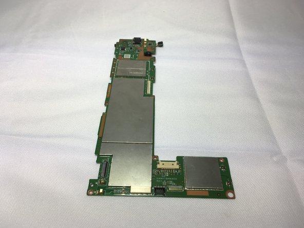

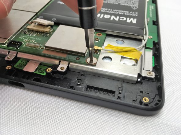

    • Remove the 10 screws from the motherboard using a Phillips #0 screwdriver.
    • The screws shown in the first picture are the more common 4.76 mm.
    • The screw shown in the second picture is shorter, 3.175 mm, than the rest of the screws
  9. Verizon Ellipsis 7 Screen Replacement: crwdns2935265:09crwdnd2935265:01crwdnd2935265:02crwdne2935265:0 Verizon Ellipsis 7 Screen Replacement: crwdns2935265:09crwdnd2935265:02crwdnd2935265:02crwdne2935265:0

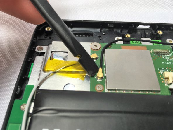

    • Remove the 5 antenna cable connectors from the motherboard using a spudger.
  10. Verizon Ellipsis 7 Screen Replacement: crwdns2935265:010crwdnd2935265:01crwdnd2935265:03crwdne2935265:0 Verizon Ellipsis 7 Screen Replacement: crwdns2935265:010crwdnd2935265:02crwdnd2935265:03crwdne2935265:0 Verizon Ellipsis 7 Screen Replacement: crwdns2935265:010crwdnd2935265:03crwdnd2935265:03crwdne2935265:0

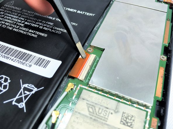

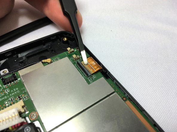

    • Disconnect the two ZIF connectors that are connected to the motherboard with a spudger. Lift up the metal part of the connector and then pull the connector off of its port
    • Once disconnected pull away from its connector carefully with tweezers.
    • Once the connectors have been disconnected you can gently lift up on the motherboard to remove it from the device.
  11. Verizon Ellipsis 7 Screen Replacement: crwdns2935265:011crwdnd2935265:01crwdnd2935265:02crwdne2935265:0 Verizon Ellipsis 7 Screen Replacement: crwdns2935265:011crwdnd2935265:02crwdnd2935265:02crwdne2935265:0
    • Remove the motherboard from the tablet.
    • Use the spudger to disconnect the press lift connector.
