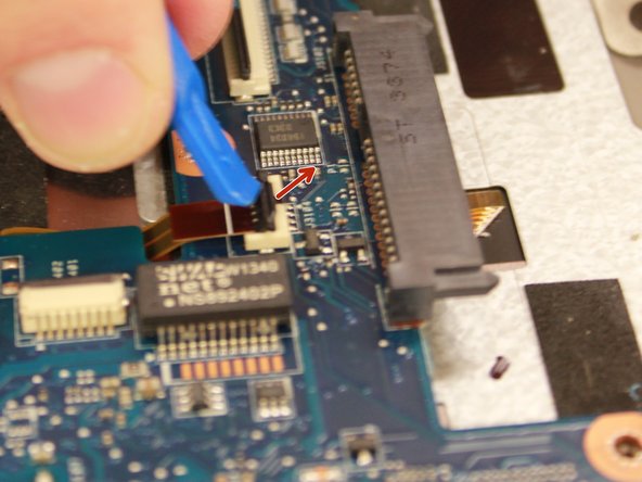

  • Using a plastic opening tool, lift up the black ribbon tab and the smaller orange tab which are connected to the keyboard underneath.
  • Unplug the ribbons.
