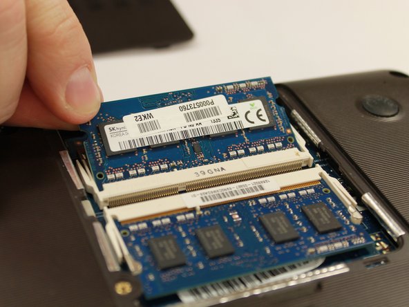

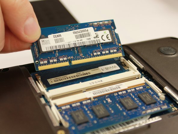

  11. Toshiba Satellite P55t-A5116 Keyboard Replacement, Keyboard: crwdns2935265:011crwdnd2935265:01crwdnd2935265:03crwdne2935265:0 Toshiba Satellite P55t-A5116 Keyboard Replacement, Keyboard: crwdns2935265:011crwdnd2935265:02crwdnd2935265:03crwdne2935265:0 Toshiba Satellite P55t-A5116 Keyboard Replacement, Keyboard: crwdns2935265:011crwdnd2935265:03crwdnd2935265:03crwdne2935265:0
    • Pull out the latches on either side.
    • The RAM should pop up.
    • Remove the RAM.
    • Repeat for the other side.

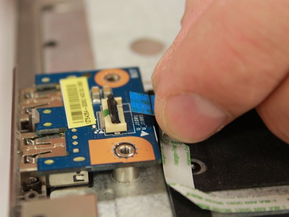

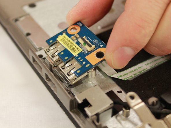

  14. Toshiba Satellite P55t-A5116 Keyboard Replacement: crwdns2935265:014crwdnd2935265:01crwdnd2935265:03crwdne2935265:0 Toshiba Satellite P55t-A5116 Keyboard Replacement: crwdns2935265:014crwdnd2935265:02crwdnd2935265:03crwdne2935265:0 Toshiba Satellite P55t-A5116 Keyboard Replacement: crwdns2935265:014crwdnd2935265:03crwdnd2935265:03crwdne2935265:0
    • Use a plastic opening tool to gently lift the black ribbon tab and unplug the ribbon cable.
    • Remove the ribbon.
    • Lightly pull up the USB Port from the metal supports and take out of the laptop.

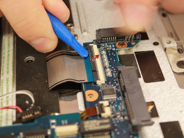

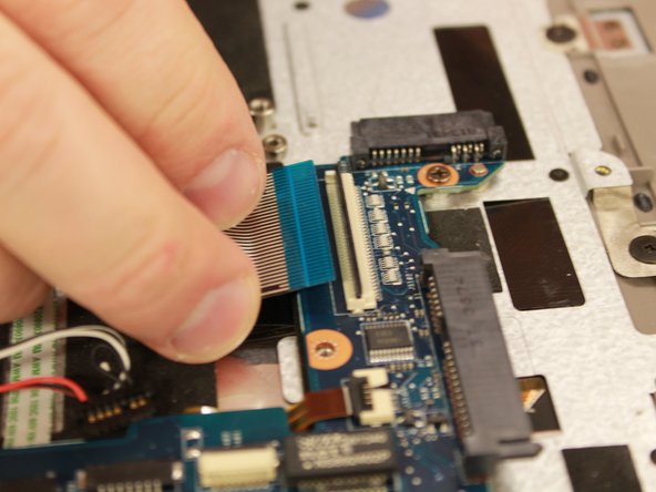

  17. Toshiba Satellite P55t-A5116 Keyboard Replacement: crwdns2935265:017crwdnd2935265:01crwdnd2935265:03crwdne2935265:0 Toshiba Satellite P55t-A5116 Keyboard Replacement: crwdns2935265:017crwdnd2935265:02crwdnd2935265:03crwdne2935265:0 Toshiba Satellite P55t-A5116 Keyboard Replacement: crwdns2935265:017crwdnd2935265:03crwdnd2935265:03crwdne2935265:0
    • Using a plastic opening tool, lift up the black ribbon tab and the smaller orange tab which are connected to the keyboard underneath.
    • Unplug the ribbons.
