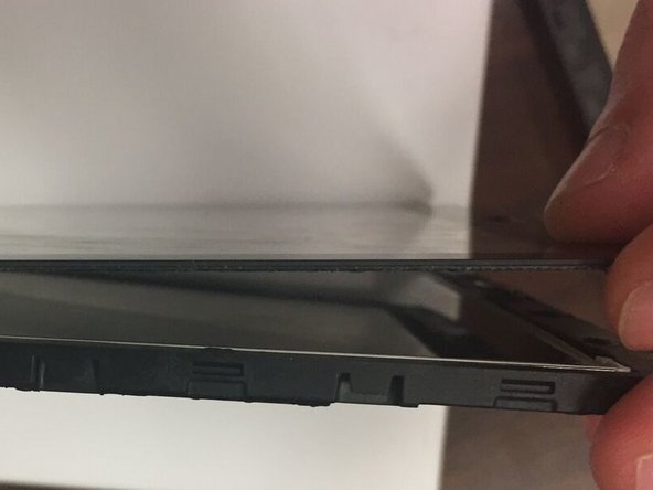

  • Turn the device back over and use a plastic opening tool to detach the adhesive glue securing the front casing.
  • You will need to wedge a plastic opening tool in between the front casing and the screen. Then move the tool around the perimeter of the device to break the adhesive.
  • Once you've loosed the front panel enough with the prying tool, you can use your hands to pull the front panel off of the device.
