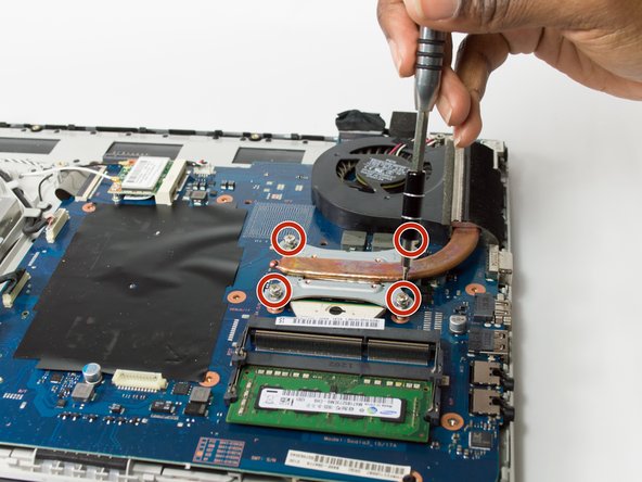

  • Unscrew the four 8.9mm screws using a Phillips J0 Screwdriver by rotating the screwdriver in the counter clockwise direction.
  • The screws will only loosen to the point to where you can remove the vent, so you will not be able to fully remove the screws.
