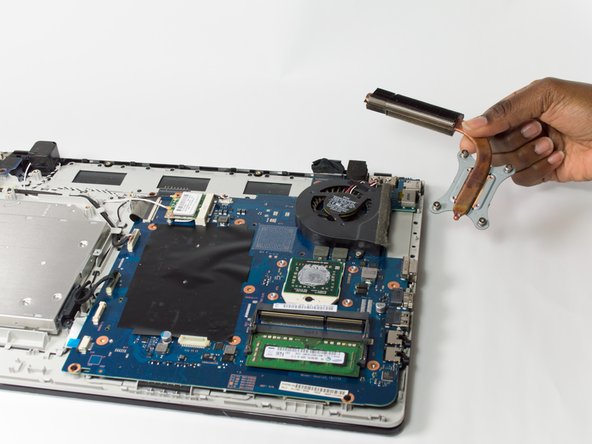

  14. Samsung NP305E5A-A03US Fan Replacement, Fan: crwdns2935265:014crwdnd2935265:01crwdnd2935265:01crwdne2935265:0
    • Unscrew the four 8.9mm screws using a Phillips J0 Screwdriver by rotating the screwdriver in the counter clockwise direction.
    • The screws will only loosen to the point to where you can remove the vent, so you will not be able to fully remove the screws.
  15. Samsung NP305E5A-A03US Fan Replacement: crwdns2935265:015crwdnd2935265:01crwdnd2935265:02crwdne2935265:0 Samsung NP305E5A-A03US Fan Replacement: crwdns2935265:015crwdnd2935265:02crwdnd2935265:02crwdne2935265:0
    • Remove the vent by lifting it away from the laptop.
  16. Samsung NP305E5A-A03US Fan Replacement: crwdns2935265:016crwdnd2935265:01crwdnd2935265:01crwdne2935265:0
    • Pull the cord that connects the Fan to the Motherboard to disconnect it.
  17. Samsung NP305E5A-A03US Fan Replacement: crwdns2935265:017crwdnd2935265:01crwdnd2935265:01crwdne2935265:0
    • Unscrew the two 4.45mm screws using a Phillips J0 Screwdriver by rotating the screwdriver in the counter clockwise direction.
  18. Samsung NP305E5A-A03US Fan Replacement: crwdns2935265:018crwdnd2935265:01crwdnd2935265:01crwdne2935265:0
    • Remove the Fan by lifting it towards you.
