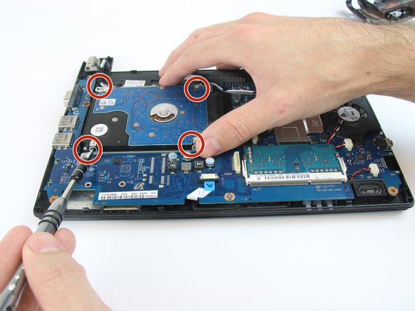

  • Use a Phillips #0 screwdriver to remove the four 4.5 mm bracket screws holding the hard drive onto the motherboard.
  • Take care not to remove the screws holding the bracket to the motherboard, as you will need that bracket to attach the next hard drive.
