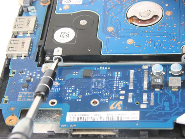

  4. Samsung NP-N102S-B05PH Hard Drive Replacement: crwdns2935265:04crwdnd2935265:01crwdnd2935265:03crwdne2935265:0 Samsung NP-N102S-B05PH Hard Drive Replacement: crwdns2935265:04crwdnd2935265:02crwdnd2935265:03crwdne2935265:0 Samsung NP-N102S-B05PH Hard Drive Replacement: crwdns2935265:04crwdnd2935265:03crwdnd2935265:03crwdne2935265:0
    • Use a Phillips #0 screwdriver to remove the four 4.5 mm bracket screws holding the hard drive onto the motherboard.
    • Take care not to remove the screws holding the bracket to the motherboard, as you will need that bracket to attach the next hard drive.
  5. Samsung NP-N102S-B05PH Hard Drive Replacement: crwdns2935265:05crwdnd2935265:01crwdnd2935265:03crwdne2935265:0 Samsung NP-N102S-B05PH Hard Drive Replacement: crwdns2935265:05crwdnd2935265:02crwdnd2935265:03crwdne2935265:0 Samsung NP-N102S-B05PH Hard Drive Replacement: crwdns2935265:05crwdnd2935265:03crwdnd2935265:03crwdne2935265:0
    • Lift the hard drive up and gently pull off the SATA cable that is currently connected to the board.
    • The hard drive is now fully removed from the laptop.
