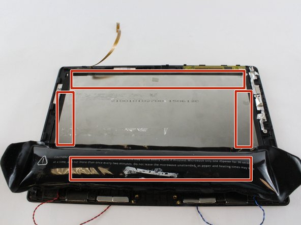

  • Use a heating pack (iOpener), a hair dryer, or heat gun, and place it over the highlighted glue areas.
  • This will heat up the glue beneath the tape in order to separate the LCD from the screen.
